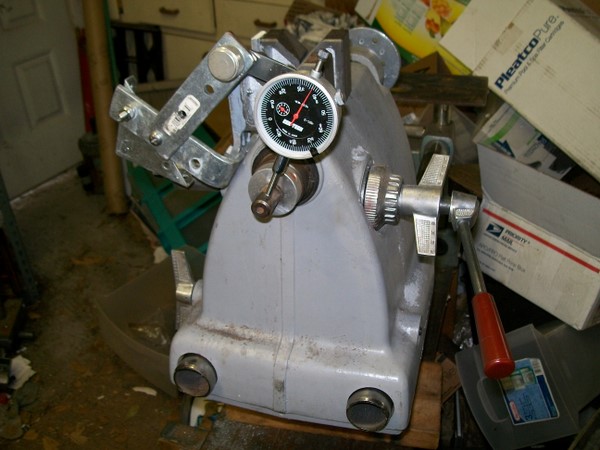

Picture 303 is my setup for checking quill shafts as I find about 25% of the quill shafts are bent (.002"-.020").
[ATTACH]13856[/ATTACH]

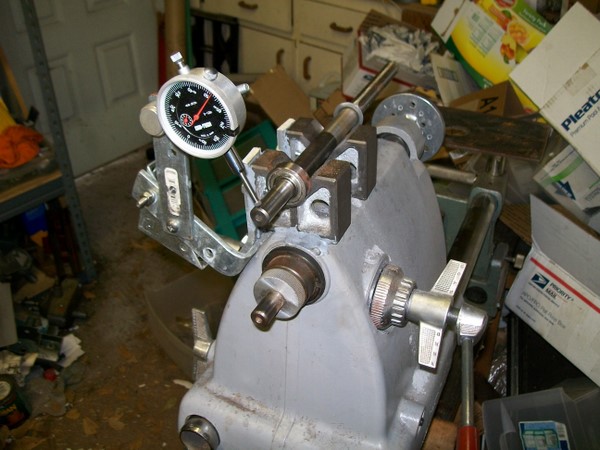

Picture 304 is my setup for checking the shaft and bearings.
[ATTACH]13857[/ATTACH]

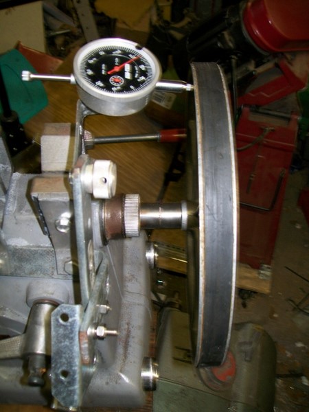

Picture 306 is my setup for straightening the bandsaw wheels. I find about 1/3 of the bandsaw wheels needs straightening.
[ATTACH]13858[/ATTACH]
