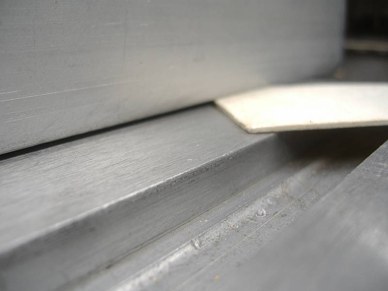

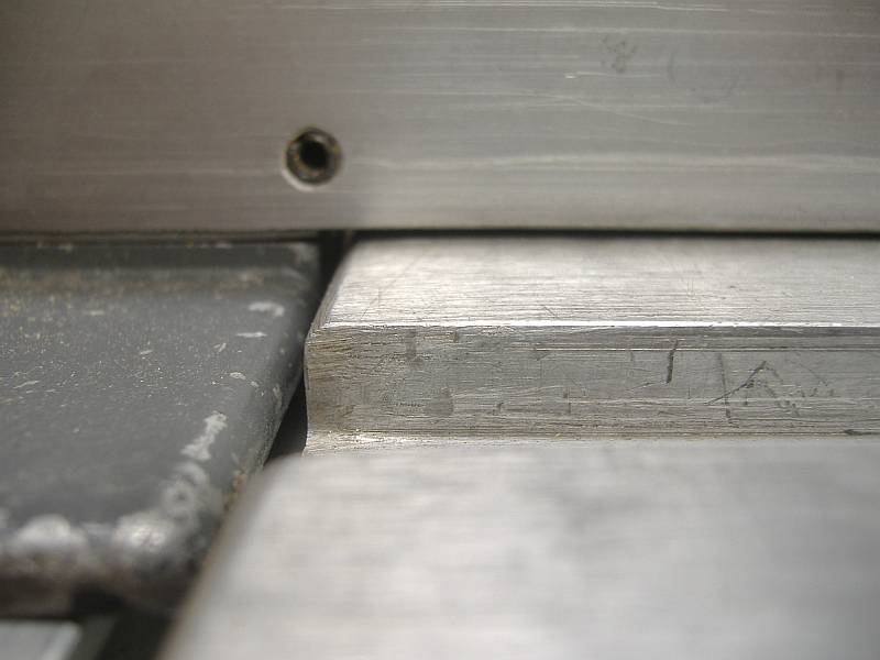

So first some pictures and details. As I mentioned there is a "normal" space between the rip fence bottom and table. As seen here on one of my 500's:
[ATTACH]14065[/ATTACH]
In the next picture you see that this very thick piece of laminate has no problem sliding under the fence. If you attempt to rip the thin laminate to width the leading edge can slip under with no problem, well yes a problem for you as you wreck the material.
[ATTACH]14067[/ATTACH]

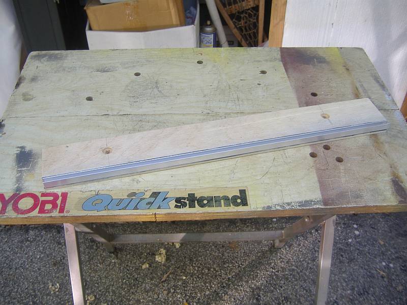

The extra fence face attached using the holes in the fence and a carriage bolts (bolts missing in photo but you get the idea). As you can see the channel sits on the table and the stock will slide in the channel.
[ATTACH]14068[/ATTACH]
Here is a shot of the fence face, size for the 500.
[ATTACH]14069[/ATTACH]

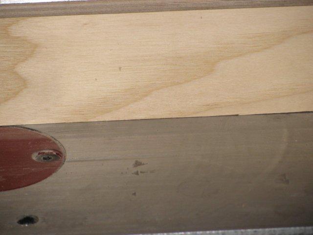

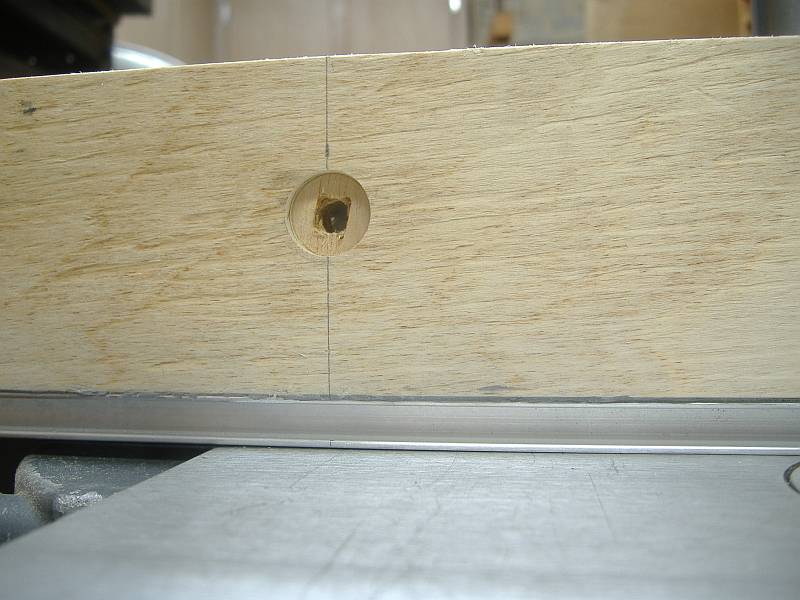

When I built this first one I knew I might be getting in over my head trying to get all the epoxy in place and the clamps on in time.
I did a couple of practice runs and it looked like I'd have at least a minute to spare. I believe I was using J B weld as that has been a favorite for years... how ever I can not be sure any more. It has a 4 minute set time.
I ruffed up the channel on the glue sides with sandpaper then clean it up.
I had test fit the wood and channel to be sure things fit. The surfaces that were not being glued I taped to keep them clean.
I mixed and then applied the epoxy to the wood, covering all the wood surface that needed glue.
I used about a dozen clamps to keep the channel against the wood surfaces in both directions.

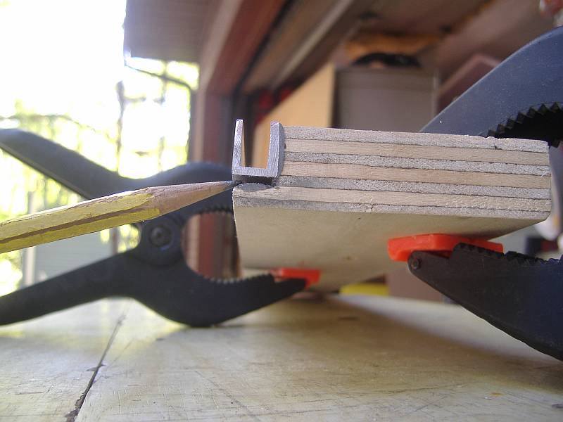

I left it clamped for hours then removed the clamps. Set it aside and more hours later I went to remove the tape and notice this:
[ATTACH]14070[/ATTACH]
This amounts to 1/16" of error!
I thought of things that might have gone wrong but I never knew for sure which of them was the problem.
I thought maybe I didn't notice when I clamped it but I can't believe that as it is very large error to not see???
I though maybe the epoxy had hardened to quickly and the clamps were not able to over come this and I missed it happening???
Maybe the mix was weak on hardener and didn't set right, or I took the clamps off to soon???
I have used this fence addition by adding a washer between the fence and wood and it sort of works but I've never been happy with it. Now I've located the "U" channel again and want to do a redo.
My plan is to do a 500/520 version that has both mounting hole and is as long as the 520 (extra length is not a problem on the 500).
So anyone have any other ideas about what went wrong?

I can't tell if it's a bad cut on the end or a lack of glue. Next one cut long, then cut rabbit. Trim to length and when gluing, use plenty.
double epoxy the wood
I have used West System 105/205 to successfully bond an Al strip to fir. They recommend that you first coat the wood and give it a few minutes to soak in before applying the final coat and the Al. They also recommend coating the Al with epoxy. They recommend an Al cleaner but I did what you did: sanded and cleaned with acetone.
Of course, the West epoxy is very thin and has a pot life advertised at 10 min. but I found that by mixing the epoxy on a flat sheet of glass rather than in a cup I got a longer pot life due to less heat concentration.
I also used spring clamps about every 5 inches.
West sells a 'kit' 101-TS Epoxy Packet but it only comes with the fast hardener 205. You get 13.75 ml of 105 and 2.75 ml of 205. Saves having to measure anything.

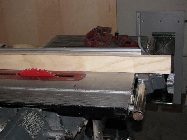

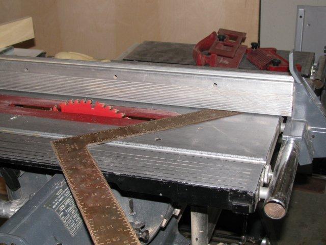

My solution to a similar issue.....
I like to use a framing square on my 510 to set my rip width....the gap under the fence allows the square to slip under (Attachment IMG_9974).
I use a scrap piece of 3/4" cabinet grade plywood as an aux fence (Attachment IMG_9975).
No more gap. Close-up: (Attachment IMG_9976)
