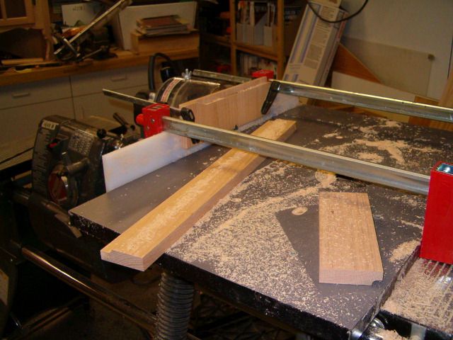

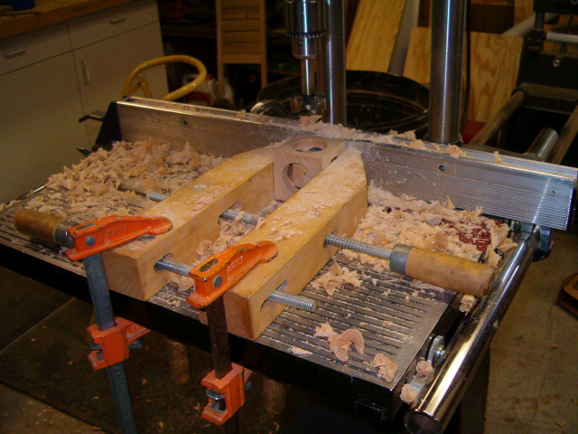

I usually use a Pony clamp. The screw end has enough reach to clamp on a flat area on the bottom of the table. In searching for a Pix, I found I had also used Bessy K-body clamps. Although these pix were taken with an OPR table, you can see the use. I have also used wooden hand screws (no photo).
[ATTACH]507[/ATTACH]
[ATTACH]508[/ATTACH]
- vertical core box bit.jpg (122.49 KiB) Viewed 16155 times
- set up for raised panel.jpg (137.21 KiB) Viewed 16156 times

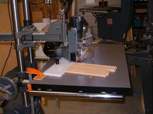

Photo of another use of clamps
Here is another snapshot of use of clamps on the SS.
This is a scrap piece of maple remaining from turning. Got tired of cleaning the shop and decided to make a box in a box. (American Woodworker #130 Sept., 2006) Gonna put shaky eyes on the little box and call it an Eye Pod.
That idea stolen from AW #132 - letters.
The longer Pony clamps sould work here.

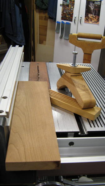

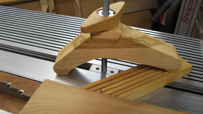

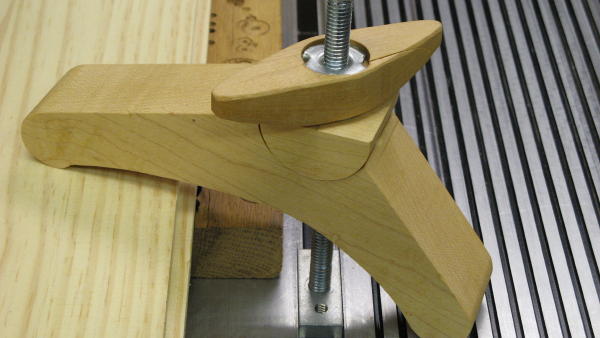

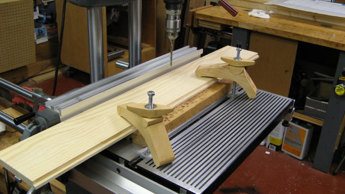

Clamping with Hold downs
In this thread we discussed clamping stock or fixtures to the SS table. I started the discussion and commented that when I used C-clamps the swivel pad always seems to end up on the structural webbing on the underside of the table. Many of you offered suggestions but the one that interested me the most was from tchwrtr55 who said I could use the “T” nuts. Offline he was nice enough to provide some pics.
I made these hold downs (see pics if I'm not technologically impaired this morning) that work swell with the SS “T” nuts. (I’m not suggesting this is an original idea, many of you may be using “T” nuts like this, but it’s new for me. I think they work particularly well in drill press mode and for horizontal boring. Unfortunately they don’t work so well to hold a feather board when ripping because the miter slots aren’t far enough away from the saw blade when ripping wider stock. (If only I could purchase a floating extension table with a “T” slot.)
My recollection is the hold downs were made for a mortise cutting jig I’d made from Woodsmith Magazine some years back. The jig never worked well for me but I started using the hold downs from time to time on my workbench where they perform well.
I’m sure you can purchase colorful aluminum hold downs from one of the many corporations that hawk woodworking paraphernalia but they were kind of fun to make. I personally enjoy making jigs and accessories more than making the projects.
The wood for these came from a Elm tree in my yard that succumbed to Dutch elm disease, which ravaged tree lined streets throughout the Midwest for years. What a great wood to work with.
