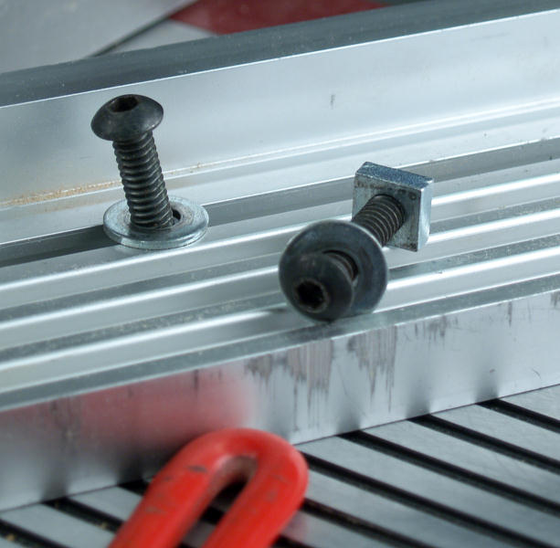

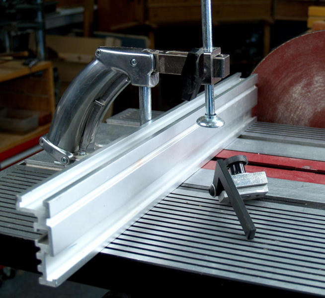

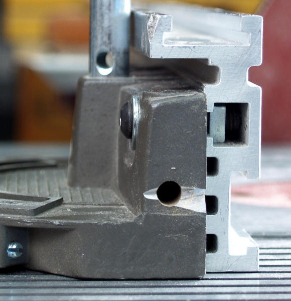

Ed, you're spot on. The fence is #556005 -- http://www.shopsmith.com/ownersite/item ... tem=556005. And just like Tampanian Ed noted, the marketing weenies have neglected to put up a picture. Here's a few I just snapped:
[ATTACH]513[/ATTACH]
[ATTACH]514[/ATTACH]
[ATTACH]515[/ATTACH]
By the way, folks, this is the very same fence that comes with the Kreg Fence System for our band saw (#556030). If you've been thinking about getting one of these for Christmas, you can use my video tip as another way to justify spending the money. Or, if you already have a Kreg band saw fence, then you don't need to spend any more money.
I have to admit that I do like the fence on the miter gauge for the simple reason that you can quickly adjust it left or right and attach or detach expendable wooden faces when needed. You can make a dynamite finger joint jig with it, as well. Maybe I should do a Sawdust Session on this accessory...

I have the Kreg Fence (in the box, until next weekend) but where did you get the screws and nuts that hold the fence on the mitre gauge? Are they special?

...where did you get the screws and nuts that hold the fence on the mitre gauge?
Its my understanding that they come with the Kreg package, Paul. The Kreg package is actually a combination of three other packages, including #556005 -- which itself includes the fence extrusion, the flip stop, and the bolts and nuts. In short, everything I show in the photos minus the miter gauge. Let me know it it's otherwise.
