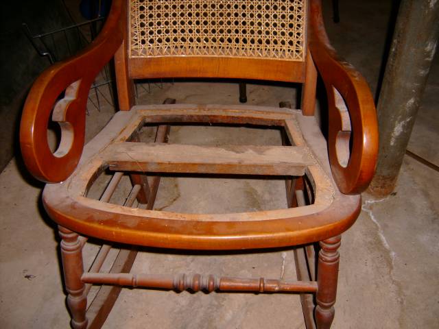

I could use some pointers on a project I have in mind. A departed relative of mine removed the cane seat from a Lincoln Rocker (I think that is what it is called) and fitted it with a plywood seat. I would like to restore a cane seat to it. Photos would be outstanding. I recaned the back of the chair a number of years ago. I have some hard maple on hand for this project. Part of the problem will be getting the appearance of the aged (yellowed) varnish.
I am going to attempt to attach a photo.

I do not seem to be having much success attaching photo. Maybe I will try again tomorrow evening.

OOOOOOPs. Forgive me. It is the woodworking (and finishing) I have the questions about. The size and shape of the opening, approximate number of cane holes around the perimeter of the opening. Also any possible thoughts on gluing the wood in place. In my years I have only seen one other chair similar to this. That chair being, I think, at Living History Farms in Des Moines, Iowa. Not for certain on that though.
OOOps! Me too! The number and spacing of holes, as well as finishing is what I thought (hoped) you could find at Rocklers. The "Caner's Handbook" (87587)(143 pages), looks like a winner.
Sorry, can't help with your finishing. If you finnish the seat the same way you did the back - they should match in a couple of years. In the photo, the back looks new!

I have a question are you sure the orignal had a cane seat? If so how was it attached to the Rocker? I seriously question whether the rocker ever had a cane seat.
Many Rockers made like that had embossed leather covered seats or fabric upholstery seats. That is what it looks like to me, the rocker either had a leather seat or hard seat. Looking at the photo the wide unfinished sections and crossbar in the middle is going to make a cane seat fairly rough to sit on, and they look to be an original part of the Rocker. If the unfinished sections are in fact original I would seriously reconsider trying to cane the Rocker. The cross bar would make the seat very uncomforable and if it was original it is probably structural so removing it may compromise the whole rocker.
If you insist on caning the rocker seat I would consider routing a groove in the unfinished portion of the seat where the unfinished meets the finished. Then using prewoven cane fabric and continuous spline attach the cane seat.
As for matching the color in Maple good luck! However I would experiment with Shellac. Garnet and/or Amber(orange) shellac should be a good starting place. In fact I would guess the Rocker was done in Garnet Shellac.
