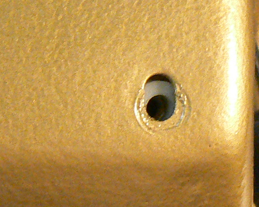

The first 'alteration' is to slot the mounting holes since the splayed angle of the motor mounting holes will move the center of the screw holes outward. The white thing inside the hole is a 1/4" thick nylon spacer.

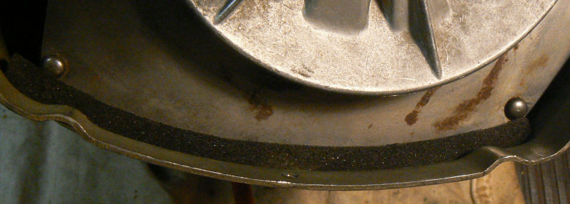

A seal is added at the exhaust vent louver to assure proper air flow. There is another foam seal on the inner edge of the louver also.

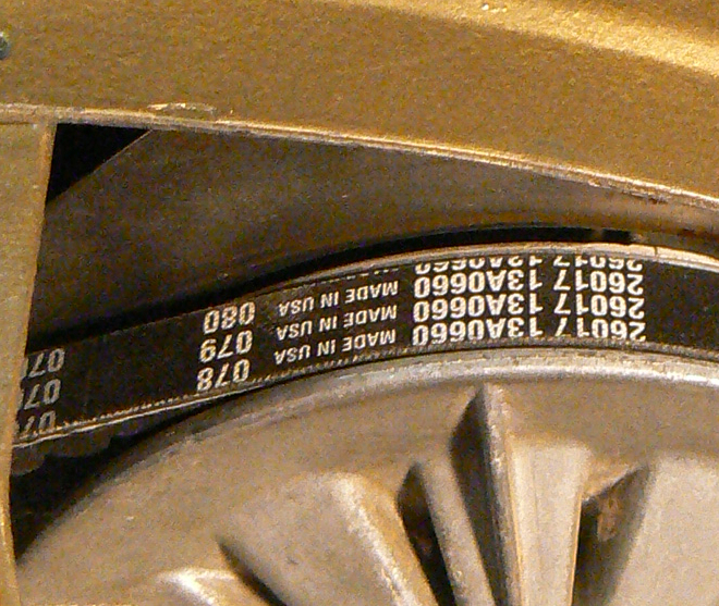

The 26" belt at high speed. The 13A0660 refers to 13mm wide x 660mm long. I do not recall the brand(sorry). The 26017 may help narrow that down.

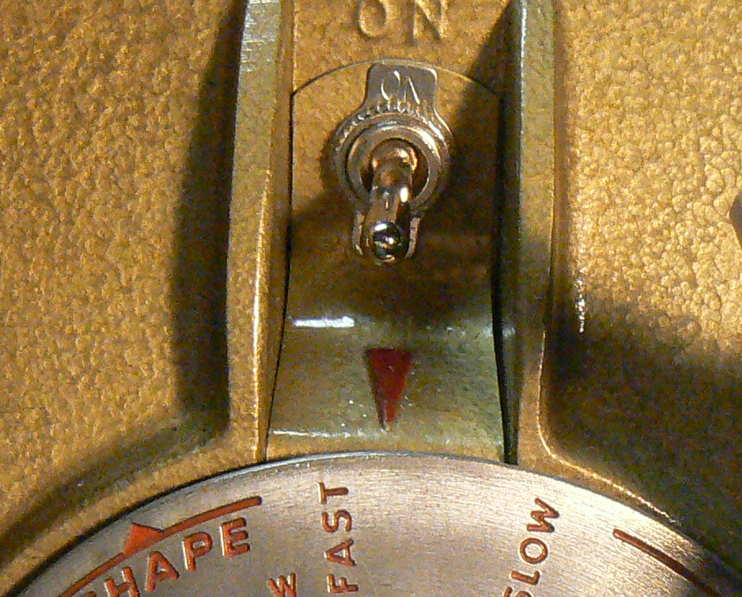

The High speed limit.

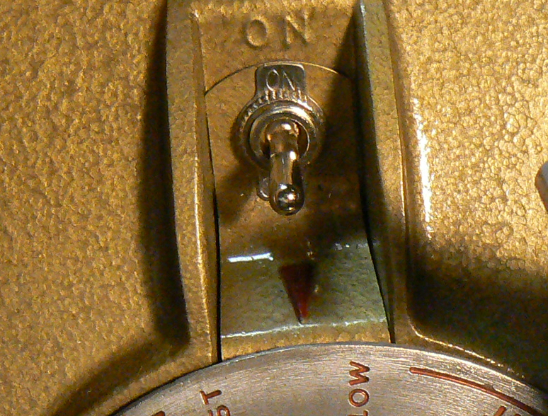

The low speed limit. The excess range can be reduced by having the belt in further from the periphery of the pulley when performing high speed adjustment(limit).

jayp413 wrote:Nice work! The extra reach both up and down the speed dial will be a huge perk!
Actually not so much so. Although the dial travels further, the actual speed variation flattens out so not much extended range is obtained. This setting will(I think) self adjust towards normal dial limits as the belt wears(thinner) and drops further into the motor pulley. Unfortunately it will be the wrong direction! It would be better to have too little range at first. The lower 'limit' is always the belt bottoming out in the motor pulley(every thing else being 'normal').
