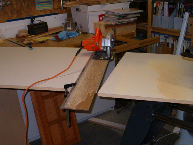

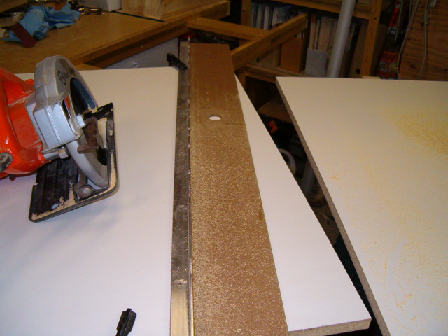

To saw a straight edge you could make one of these. They can be any length you want. A 4 ft. one and an 8 ft one would be just right for a shop. You can hang them on a wall when not in use and they are out of the way. I use my 4 footer frequently. It's nothing more than a 1.5 inch aluminum angle iron screwed onto a piece of hardboard. You will have to use the SS to saw off part of the upright so that the circle saw won't hang up on it. After the aluminum is attached to the hardboard - just run the saw down the board while held against the aluminum and you have a straight edge that is exactly where the inside of your circle saw will pass. Using clamps you can mount this guide and precisely adjust your cutting line.
- straight cutting guide.jpg (118.59 KiB) Viewed 13720 times
- straight edge - circle saw.jpg (118.86 KiB) Viewed 13711 times
