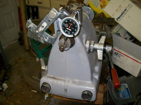

With the quill assembly installed in the headstock and the Quill Lock Handle tighten, I look for a max of .002" runout. I find 20-25% of the quill shafts I check have .003 and greater runout. I replace the quill bearing first. Iif the quill shaft still has .003 or greater runout, then I replace the quill shaft.. This is only my opinion for my standard.
[ATTACH]14418[/ATTACH]
