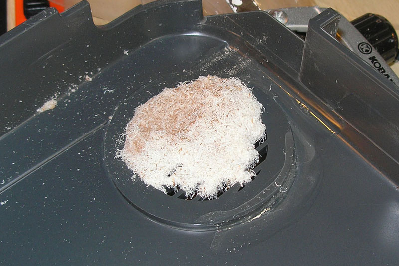

I had seen the recent postings concerning the tendency of the dust port (which has a cast in grid work) to catch the dust and was very interested in how my new setup would work. The answer is - not so good.
[ATTACH]14456[/ATTACH]

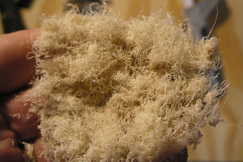

The sawdust (apparently because this was green wood) was really quite long strands and gummy and, boy, did they block the dust port. Big time. This is a picture of the sawdust all by itself:
[ATTACH]14454[/ATTACH]

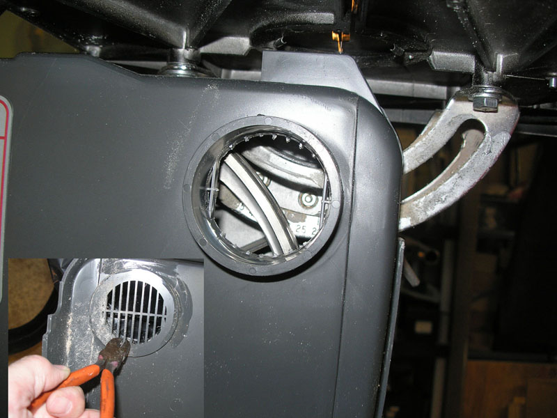

This obviously was unacceptable so I cut out the grid work:
[ATTACH]14453[/ATTACH]
And the results were much better. Of course the moving parts of the bandsaw are much more accessible and I'm sure SS would not approve of this change from a safety standpoint but it does seem to work. No plugging and less sawdust left inside the cover.

Some time back on this forum someone had actually called Shopsmith and got an "OK" to cut out those grid-pieces. I have cut out every other one of my grid-pieces and I'm doing all right with that now.

That would have been me that called SS. They talked to engineering for me to make sure that was no structural problems with cutting out the grid. I left in a cross just to be sure and have had no problems since doing that. It would happen even with dry wood not just green.
