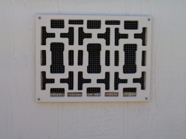

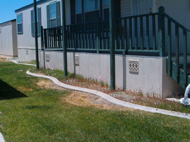

In January, 2009 I made 20 vent covers for the skirting around my home. Made 5 from cabinet grade plywood and 15 from 1/2" MDF. The finishing was a good coat of "Kilz" sealer. (white paint stuff) and then several coats of house paint.
The plywood ones have all separated between plys, but the MDF ones look as good as new! Yes, it's time to make 5 new vents. All of the MDF vents were subject to all weather we have. The MDF held up very well so far.
The photos don't show a real good view of the edges, but there are edges throughout the vents.
