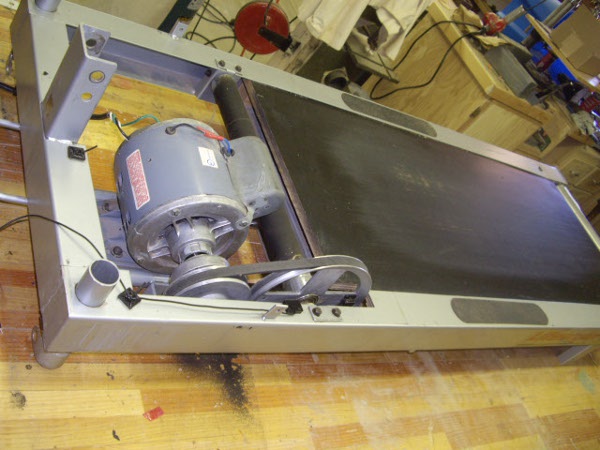

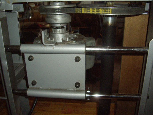

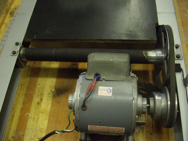

Here are some pictures of the Frankensander. Just in time for Holloween.
[ATTACH]14627[/ATTACH]
[ATTACH]14628[/ATTACH]
[ATTACH]14629[/ATTACH]
- sander.JPG (71.24 KiB) Viewed 1771 times
- motor.JPG (57.63 KiB) Viewed 1772 times
- underside.JPG (48.11 KiB) Viewed 1768 times

Belt
Looks like belt changes will involve a partial tear-down. Do-able for that kind of size!

No Belt
I believe I'll be threading a "belt" through the frame and re gluing it.
A hassle, for sure, but I won't be changing often.
Gene
I do hope that is NOT wishful thinking!:)Gene Howe wrote:I believe I'll be threading a "belt" through the frame and re gluing it.A hassle, for sure, but I won't be changing often.
Well, I really could remove the platten rollers and the bed and then slip on a pre made belt. It would be a half day job. but what the heck, I don't have anything else to do.JPG40504 wrote:I do hope that is NOT wishful thinking!:)
After due consideration, I may just do that.
