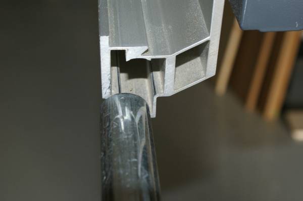

I have had alignment with my 520 upgrade for quite q while now. I can not get the auxiliary table aligned on the left end of the machine either.
The first pic shows the offset of the aux table from front to back
[ATTACH]14679[/ATTACH]

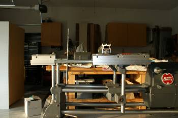

This one shows a definite tilt downward of the aux table when it is on the left end of the machine.
[ATTACH]14680[/ATTACH]

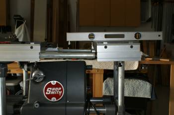

This pic is of the proper alignment of the aux table on the right end of the machine.
[ATTACH]14681[/ATTACH]
I finally gave up on trying to align the aux table on the left end of the machine. I might also add that I never got the aux table aligned on both ends even when the machine was new in 1983.
