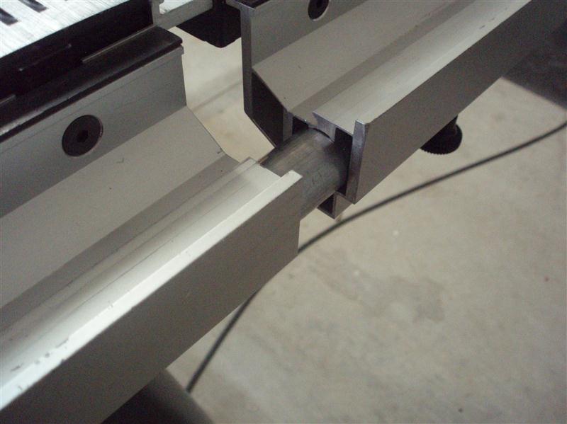

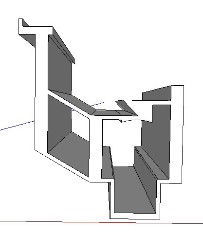

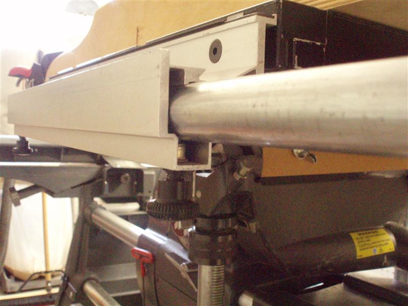

Side note: Looking at the photos you provided, wa2crk, it appears that your front 520 rail is different than mine.
This sketchup drawing by reible shows what my front rail looks like.
[ATTACH]14683[/ATTACH]
I must be missing something. I'm not seeing any difference in the close up photo on the other thread (at least the parts that are shown) to the sketch up drawing. Curious, what difference do you see?
Maybe it is not you. Maybe it is me. I was comparing these:
[ATTACH]14685[/ATTACH]
[ATTACH]14686[/ATTACH]
What looks different to me is how the two would wrap around the extension tubes.

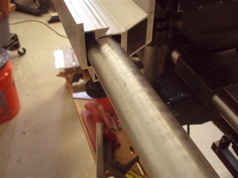

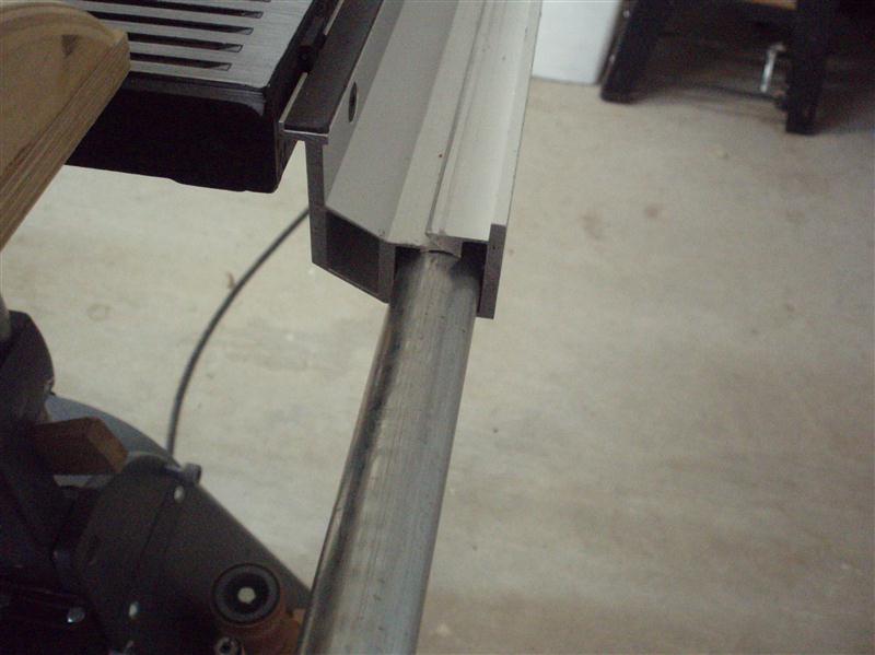

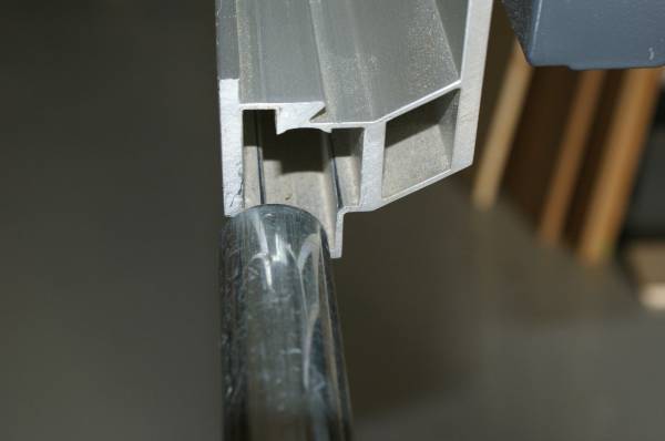

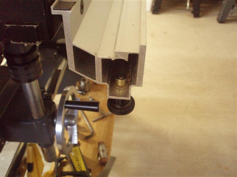

Mark V 520 Front Rail
Here are some other shots. I thought that maybe looking at the rail from different positions would reveal what I'm not seeing. NOPE
[ATTACH]14687[/ATTACH]
[ATTACH]14688[/ATTACH]
[ATTACH]14691[/ATTACH]
[ATTACH]14692[/ATTACH]
[ATTACH]14693[/ATTACH]
