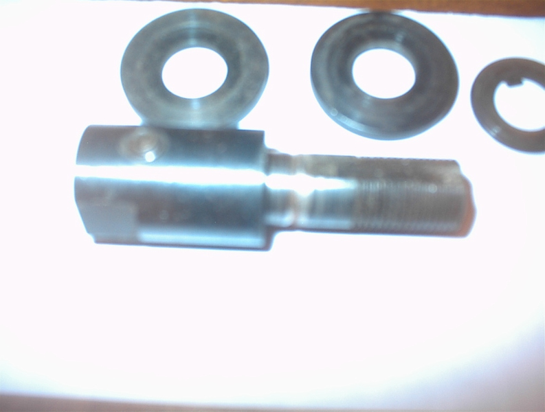

For some reason, call it luck, intuition, karma, whatever, I decided to pull the SS wobble dado off it's arbor and put it on the other one. Oh, now I remember. I was thinking maybe the washers were turned wrong or something. Anyway, when I pulled the blade off the arbor, here is what I found:
[ATTACH]14746[/ATTACH]
Hard to get a good close-up picture, so I'll explain it. There is a significant wear groove on the arbor's shaft. The groove allows enough slop to cant the blade, thus the uneven cut.
Mounted the SS wobbly to the 2nd arbor, and, PRESTO, nice clean, SQUARE cuts.

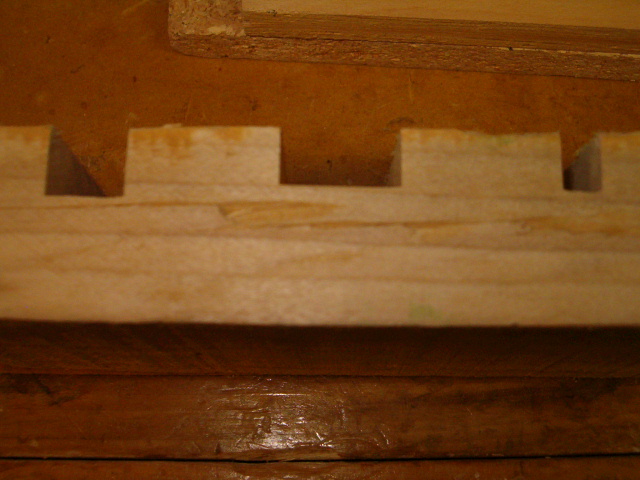

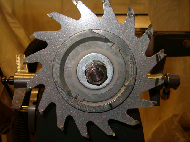

I don't know if this is a magna wobble or not, but it looks like one.
The black marks are where the blade beat on the insert.
[ATTACH]14747[/ATTACH]

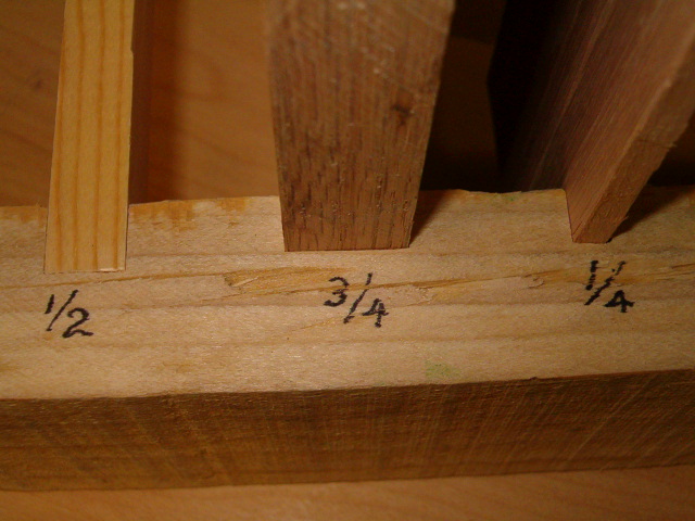

It makes dados and grooves that are reasonably square and flat. However there is a definate dip near one side in the 1/2" and a bigger dip in the 1/4" dado. The 3/4" is really flat and smooth.
1/2" is on the left, 3/4" in the middle and 1/4" on the right.
[ATTACH]14750[/ATTACH]
But when a board is inserted the dips aren't so bad anymore
[ATTACH]14749[/ATTACH]

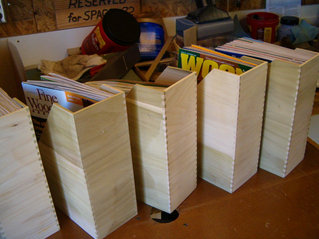

I've made lots of box joints with the 1/4" setting.
[ATTACH]14751[/ATTACH]
