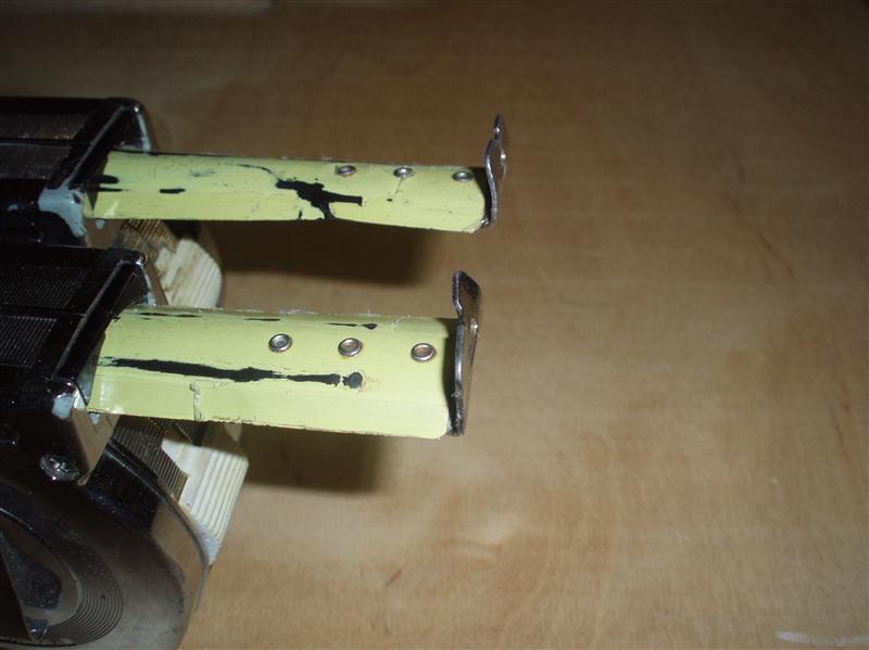

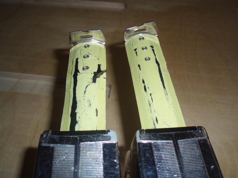

PS: I decided that I better check my tape measures. I am often enticed by this forum to double check in my own shop. Often I am thankful that I did so. This is one of those cases.
I checked my two Stanleys against one another and found that they differed by more than 1/32". A couple of the following photos tell why.
[ATTACH]14782[/ATTACH]
[ATTACH]14783[/ATTACH]
Maybe it is time for me to consider retiring these.:rolleyes: I can probably straighten the hook on the one and put it in the truck to use when I am out and around. Other than that, I guess I need to get them out of the shop.

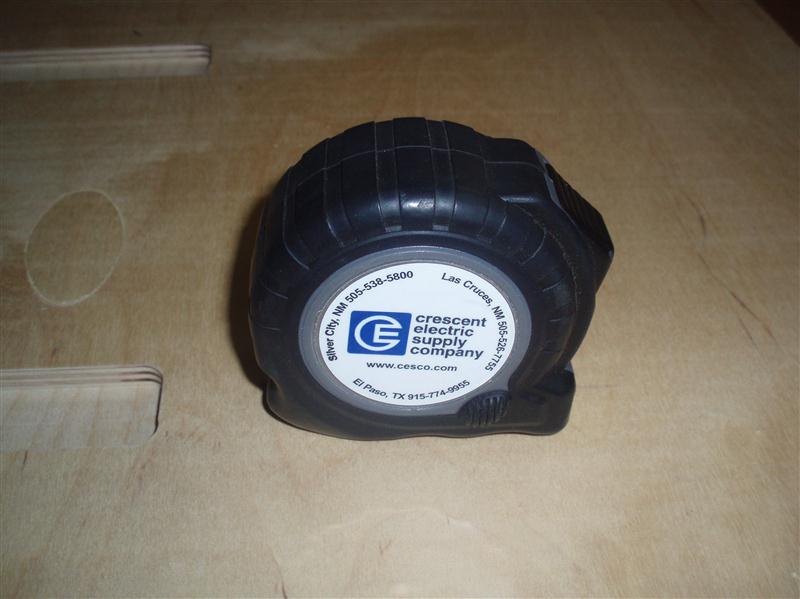

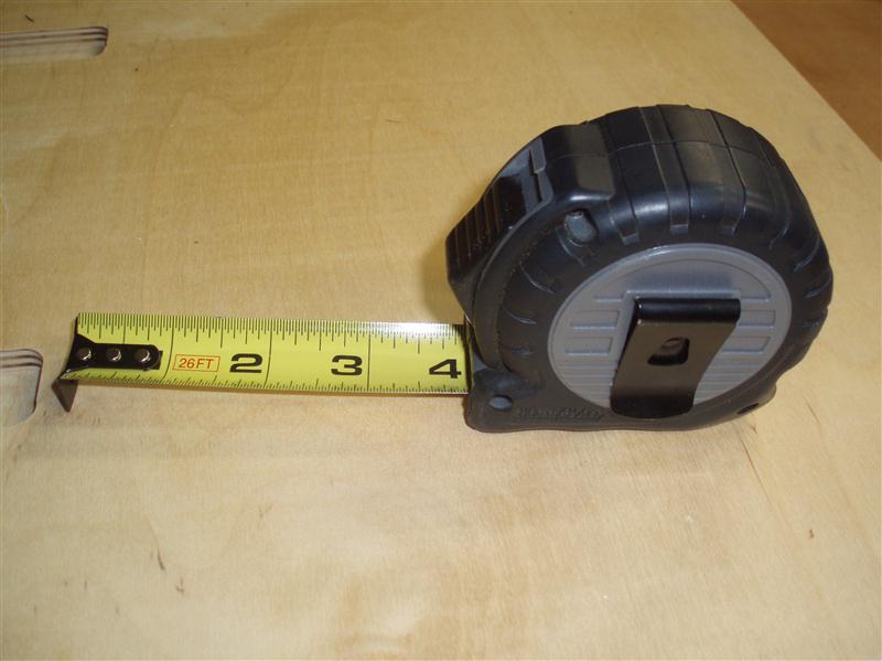

A couple other brand names have been mentioned in this thread. I have one that I am unable to identify. Maybe you guys can help.
I picked up two of these at an association meeting for a local group of architects. They were free so the price was right but I have never integrated them into my shop.
Can anyone tell me from the photos what brand they are. They feel comfortable and seem to work well and they are not bent.

Hi Dusty,
In general I have found almost all tape measures to be good for general measurements like going to the wood pile and getting a 2 x 4 that is at least say 32" for a project that needs to be 31" long.
Some say 8 or so years ago I recall posting to I think it was the Router Forums about the issue of tapes being off by what can be a lot more then 1/32". I had if I recall 3 tapes all pulled some distance then shot a photo of the distance, yes they did show the point that the length is relative to the tape measure.
The concluding I set forth is that you need to use the same tape for a project. I have failed to do this on some occasions and had some unpredictable results. I recall getting lucky one such time. I was doing some measurements for trim inside then going outside to do the cutting. One tape outside and another inside. When I had to bring the first cut piece back out to re-cut because it was too long well that wasn't to bad. However after every piece was too long I knew something was up. When I compared tapes they were more then a 1/16" different at the lengths I was cutting. If the pieces were coming out 1/16" short, well that would have been another story.
The true length doesn't often matter but just like a story stick you want the same length for measuring and for cutting, so if you use just one tape you get that, two tapes, hey maybe you get lucky, maybe not.
