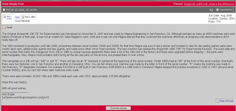

Hello All;
I have dug my Shopsmith out of the back of the garage after a twenty year resting stage. Turns out this Shopsmith is a 10 E, serial number 30421.
Any thoughts on what year this unit was manufactured?
Also, what are the differences between a 10 E and 10 ER?
This unit is al original including the optional speed changer. I plan to restore and eventually put this machine back in service.

Sure it is an E? Describe the rip fence - Does it have a lock knob at the rear?
[ATTACH]14803[/ATTACH]
If I can track down the original post, here it is http://www.shopsmith.net/forums/showpos ... ostcount=2
- 10E sn info.jpg (127.47 KiB) Viewed 1004 times
