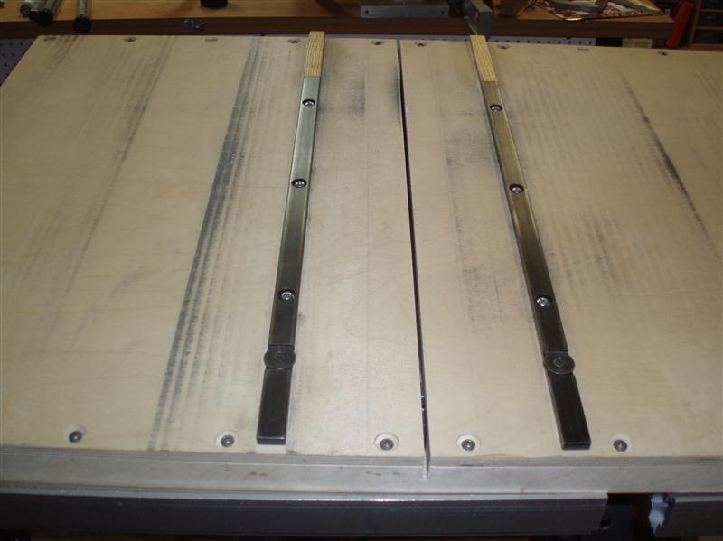

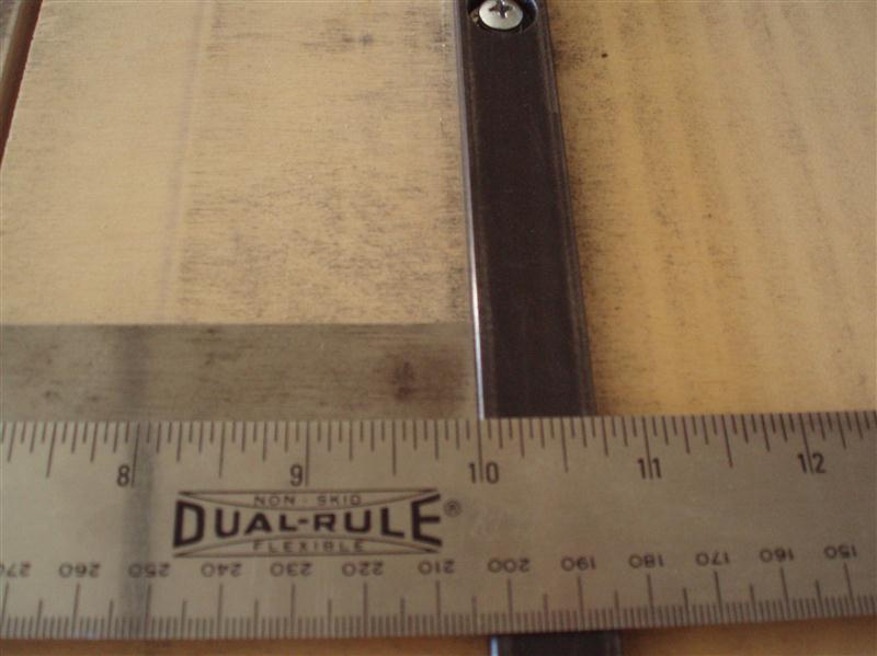

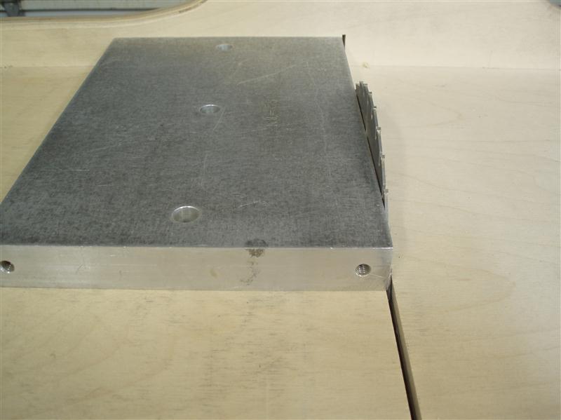

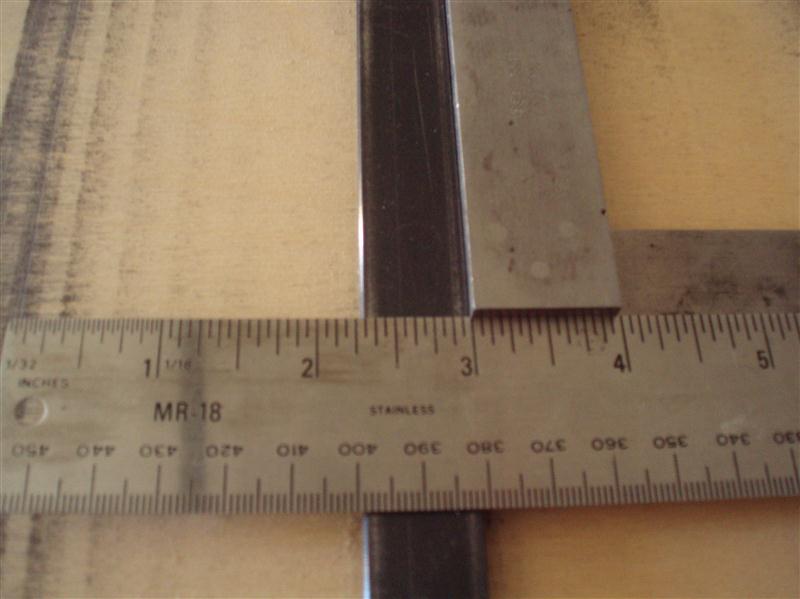

Set the table tilt so that the table top is at 90°]14820[/ATTACH]
Shopsmith Miter Bars with extensions to reduce slop when sled is extended
[ATTACH]14821[/ATTACH]
[ATTACH]14822[/ATTACH]
[ATTACH]14823[/ATTACH]
My own custom square.
[ATTACH]14824[/ATTACH]
- Cross-Cut Sled (Homebuilt) 001 (Custom).JPG (47.55 KiB) Viewed 2518 times
- Cross-Cut Sled (Homebuilt) 011 (Custom).JPG (45.75 KiB) Viewed 2508 times
- Cross-Cut Sled (Homebuilt) 012 (Custom).JPG (49.04 KiB) Viewed 2494 times
- Cross-Cut Sled (Homebuilt) 016 (Custom).JPG (42.3 KiB) Viewed 2565 times
- Cross-Cut Sled (Homebuilt) 019 (Custom).JPG (45.16 KiB) Viewed 2513 times

No that is not exactly how I did that. I had forgotten until you asked. I installed a Shopsmith miter track on one of my extension tables to facilitate the second miter bar.
When installed, the miter tracks are 22" apart. I'll look somemore for photos. I cannot imagine that I did not take pictures.
Hopefully, these will give you an idea of what I did.
[ATTACH]14828[/ATTACH] [ATTACH]14829[/ATTACH]
- Cross-Cut Sled, Shopsmith 001 (Custom).JPG (42.94 KiB) Viewed 2497 times
- Cross-Cut Sled, Shopsmith 003 (Custom).JPG (48.49 KiB) Viewed 2482 times
