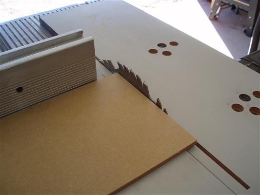

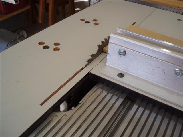

I wish I had set the depth before I took this picture but I do it the same way as when I am using the table saw.
[ATTACH]15194[/ATTACH]
[ATTACH]15196[/ATTACH]
- PA160027 (Custom).JPG (32.56 KiB) Viewed 1605 times
- PA160026 (Small).JPG (38.82 KiB) Viewed 1607 times

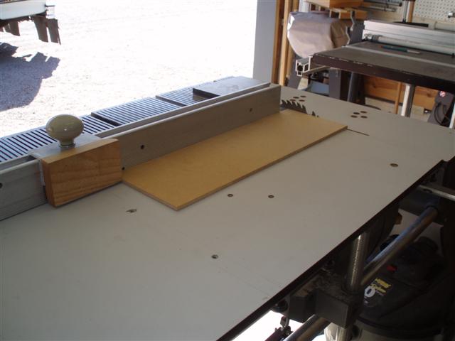

That gap does not exist in the photos which I have posted to this thread but you can see where it would be if I did not use the Auxillary Cross Cut Sled.
Notice that I have mounted my auxillary table differently than shown in the Shopsmith documentation. I created a ZCI out of mine.
[ATTACH]15197[/ATTACH]
One of these days, I am going to make a new Auxillary Cross Cut Table. The modification will be to extend it out beyond the outfeed edge of the main table probably a foot or so.
- PA160025 (Small).JPG (41.04 KiB) Viewed 1574 times
JPG...there is not a huge distance between the crosscut sled and the saw blade, I would say it's about 1/2" to 3/4" and yes I know the depth of the cross cut table. Looking at Dusty's setup really made me see that all I have to do is add the auxillary cut off accessory to the left of the blade and then If the cross cut table and the cut off accessory are the same height, I can use a gauge to measure the depth.
Dusty...I really like you ZCI setup
