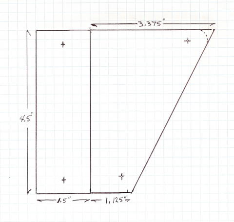

Mark V Caster Adapter for 10ER and Work Table
This is the adapter measurements I have used. I purchase scrap/left-over aluminum "L" shape 2"X4" or close material so I do not have to bend anything. You can normally get the seller to cut it into 4 pieces the length/height you need. I leave my brackets square (round the edges with a file), no angles to cut then. The casters works well for moving heavy work benchs and work tables too. I scale a paper template for drilling the holes for the correct angle.
[ATTACH]15206[/ATTACH]
- Mark V Caster Adapter.jpg (18.89 KiB) Viewed 2529 times
