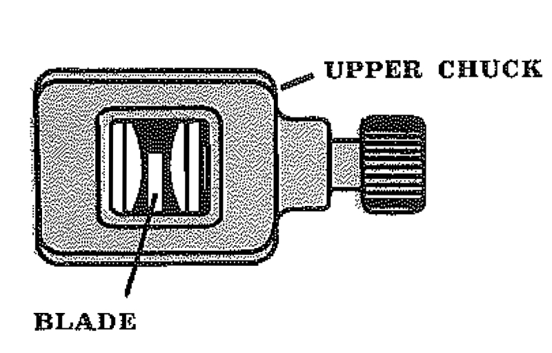

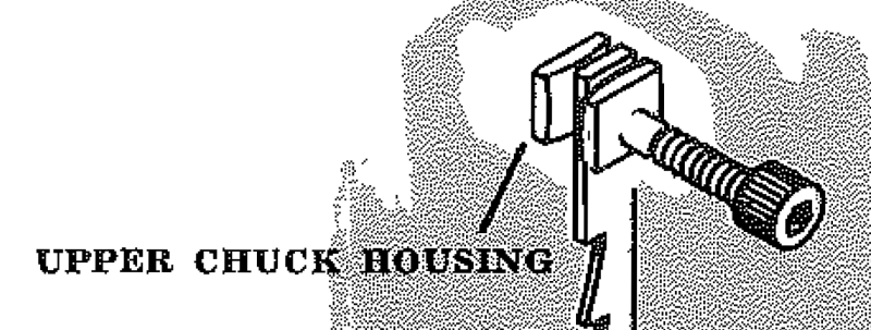

Does anyone have, or know where I can find, the upper blade chuck for a Magna Jigsaw? I have the square tube that runs inside the spring and the black cup seal that pumps the air for the sawdust blower, but I need the blade chuck that mounts on the end of the square tube.
Right now I will even settle for a couple clear pictures of those parts - the line drawings in the manual leave a little to the imagination and if I can't find the parts, I will have to make them.

Maybe this will help. The blade clamp parts have a pin on the back which fits into holes in the side of the square tube. The set of parts can be rotated 90 degrees on the square tube.
[ATTACH]15217[/ATTACH]
[ATTACH]15218[/ATTACH]

So, the square tube fits inside the chuck, and the blade clamps are inside the square tube, with pins sticking through holes in the square tube. There must also be holes in the chuck for the blade clamp pins to extend into or there would be no way to keep the chuck from sliding up or down. The set screw then pushes on the end of the blade clamp pin. I think that is the missing piece of info that I couldn't make out from the drawing in the manual.

Culprit wrote:Thank you, JPG.

JPG's post above has a couple of great drawings showing the Upper Chuck. I hope it gives you a better idea of how it all goes together.
