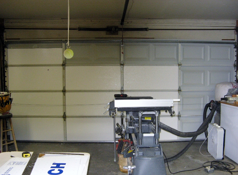

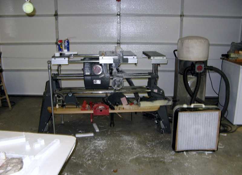

The weather has turned cold. It has been in the 40's at night. So SWMBO suggested it would be a good idea to insulate the garage door.
The washer and dryer are in the garage.
Over the years I have used ridged foam 4x8 sheets for various projects. Some that come to mind are, Trailer house skirting, Lining basement walls, and retail displays. Cutting and fitting has always been a problem. I have tried knives, table saws, hand saws, drywall saws, other saws in the arsenal, four letter words, even purchasing a saw blade that had a knife edge instead of teeth. None of the methods seem to be vary accurate or effective.
Not looking forward to the project and mess, I set up the SS. It just happened that it was set on a slow speed and to my surprise it worked. I wished that I had discovered this years ago.

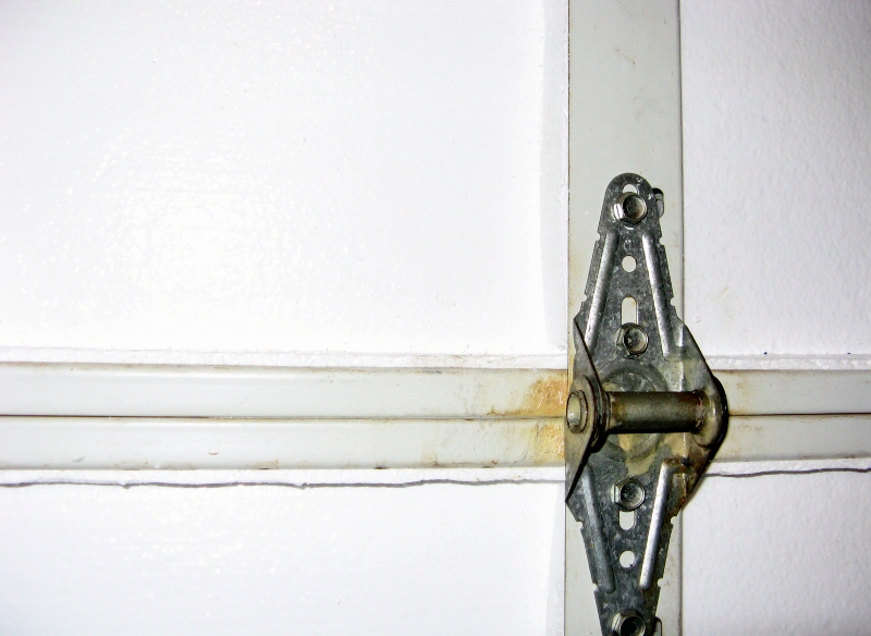

The original intent was to fit the panels and use foam in a can to seal around the edges. But the SS worked so well adjusted to low speed that I cut batten strips and wedged them around the edges to fix the panels in place. My only screwup was, the foam panels fit to tight, this expanded the door seams, which made the door hard to open and close, the door opener fault would trip. The door opener had to be readjusted.
The good news is less air infiltration between the seams.
- ss projects 004 (800x590).jpg (402.65 KiB) Viewed 1877 times
- ssprojects 002 (800x579).jpg (396.05 KiB) Viewed 1862 times
- ss projects 007 (800x584).jpg (296.09 KiB) Viewed 1869 times

I do not think so unless there is excessive air infiltration. But I can see daylight at the edge of the door.beeg wrote:Looking good there. Ya gonna seal the seams between the garage door panels?
At our local big box store they sell pipe wrap for $1.99 for a 6ft length. I am thinking I could split one into 1/3Rd's and fasten it to the garage door jam with the curved side riding on the door edge.
