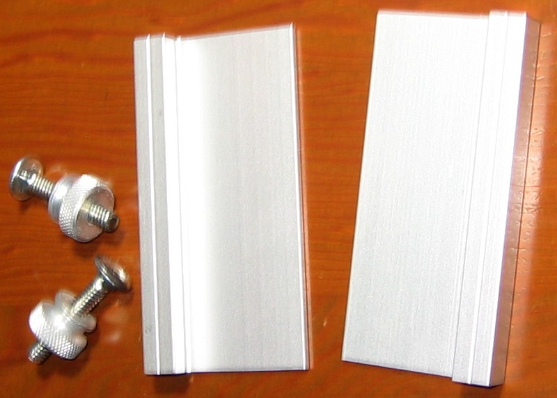

Finally, here is a picture of some parts I have but I don't know what they are for. I actually have two sets of the knurled knobs & bolts. Maybe the Owners manual will help. Any hints?
[ATTACH]15382[/ATTACH]

I believe the two aluminum parts are the gauges to set the rails to the table so they are all the same.mountainbreeze wrote:So, I went out today and picked up the 520 with bandsaw I found on Craigslist which will replace the 1977 Mark 5 that was handed down to me. It's in really good shape. The previous owner said he used it as a table saw which seems to be supported by the fact that the drill chuck, drill bits, sanding disk, and lathe tools have never been used. The band saw looks like it has been lightly used.

The two bolts and knurled nuts look like the ones that hold the wooden miter gauge extension to the miter gauge.
JPG40504 wrote:I believe the two aluminum parts are the gauges to set the rails to the table so they are all the same.
That is certainly one use for the bolts and knurled nuts but to the best of my knowledge those are piece parts.

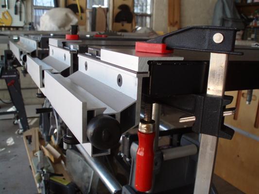

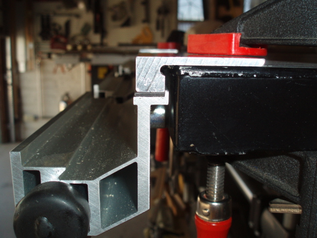

Yes, those are the rail alignment gauges. I use mine in a fashion different than stated in the instruction sheet however. The objection is to get the front rails all set at the same height with respect to the table surface.
[ATTACH]15384[/ATTACH]
[ATTACH]15385[/ATTACH]

mountainbreeze wrote:A few more questions...
If you get the rails to be aligned relative to the top of the table, how do you get the floating table to be co-planar to the main table when both are tightened to the connecting rails? How does Shopsmith suggest they be used? I loosen the screws that secure the rail to the table. I then install the extension table on tubes that have been inserted in the main table and tightened in place. Then I clamp a straight edge that is long enough to bridge both tables (I use my 4' levels) to the main table. With the extension table snugged up against the levels (clamped), I secure the screws that hold the rails to the tables.
If everything is PRECISE, the extension table can be used on either side of the main table. Any deviation from PRECISE may prevent the table from being transportable (without tweaking or ignoring the imprecise fit).
