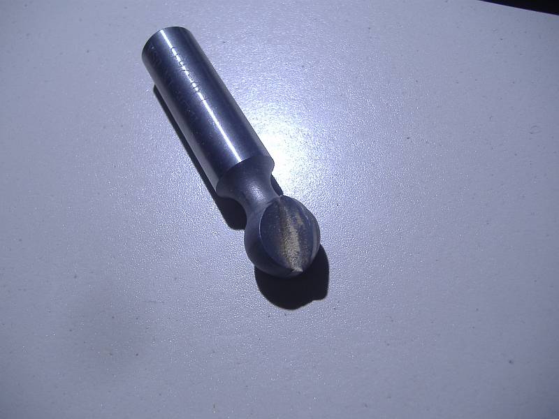

After an afternoon nap I began thinking of what I had posted and then I to thinking that maybe I should repost and add a few other things that came to mind.
First the bit you mentioned was a cove bit.
The next closes bit I know about is called a round nose and that has been mentioned. I'd like to add these bits come with and without a top bearing. If you were interested in pattern cutting the top bearing might be what you are looking for.
The other bit that comes to mind is a plunge ball bit.
[ATTACH]15813[/ATTACH]
This bit will do the a plunge to half depth or you can put more of the "ball" below the surface, of course you can only so far without having to do a first pass with a 1/4" straight bit and you will always have the slot along the top where the shaft passes.
I was thinking that perhaps a "D" shaped hole could be made even more round in one piece of wood and not require the two have holes... of course I'm guess at how this is being done.
