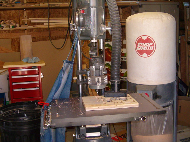

fredsheldon wrote:I just acquired my first Shopsmith V 500 and just won a 510 upgrade on E-bay. I'm thinking of purchasing the overarm pin router that mounts on the way tubes and was wondering if you have to remove the headstock each time you want to use the router. I just ordered the lift assist option if that makes any difference.
The answer is no. Here's a pic.
[ATTACH]15825[/ATTACH]
Also, find the OPR in the horizontal position is an excellent mortising machine.

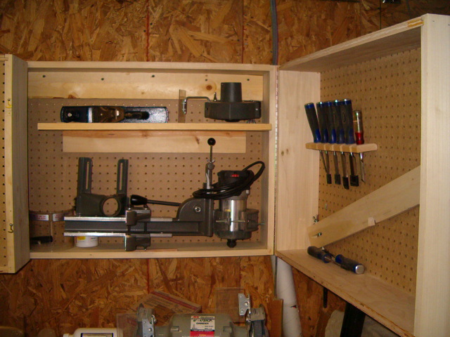

Took a long time the first few. Now takes only a couple minutes. Sometimes there are two parts to installation. Mounting the OPR and mounting the router.
In my shop, it was tricky to fine a storage place for the OPR. Once figured out, it's now a snap to put it away. Here how it is stored.
[ATTACH]15832[/ATTACH]
- Larger cabinet inside half.jpg (128.88 KiB) Viewed 2870 times

Just ordered the OPR. Thanks for your pictures and suggestions. I was thinking about getting a second unit and cut it down like Jim did. But, if it only takes a few minutes to mount and unmount the unit, I will go that route to save space.
