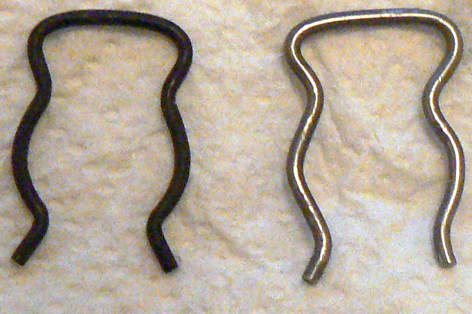

According to Dave, this part is not available. It is the wire clip that slips into a groove on the caster piston. It retains the piston.
[ATTACH]15857[/ATTACH]
A bit crude, but I think it'll do. The original(on the left) is 0.072 and I made the one from 0.078 piano wire(hobby shop). The next smaller size was smaller than 0.072, but I think it would be better. For sure it will bend easier.
He said the only way to get this part is to purchase an entire caster set!:(
I really did not like hearing that! I hope it is not an indicator of things to come!
He said since they do not repair them any more, they had no way to get the clips.:confused:

JPG40504 wrote:http://www.shopsmith.com/ownersite/itemfind.htm?item=503815&Submit=Find+Item

I tried the hairpin vlip, and it comes close, but tends to 'interfere'(it hits things). It would do as a last resort(My wire bending proved unsuccessful).
Truth be told it is unlikely that that part would break and I needed one only because a used one came without it. They might rust, but would probably still be usable.
Hard for me to believe, but the only way this msakes sense, is for SS to have farmed the entire production sequence of the caster sets out to a vendor.
A factor may be that I asked for 5 just to have some 'on hand'.

I e-mailed our 'resident fastener quality control expert' last week and I assume since he has only responded with an 'I will look' response that it is not easy to find. Got a miniature version with a box of misc. parts. Question is, when was it made and by whom, and do they still make them.
BTW Piano wire does not bend easily - especially tight bends.

That part looks a lot like some of the automotive trim clips & had experience with a number of years back. I wonder if a body shop supply place would have a catalog containing something compatible.
I suppose if you simply can't get them at all, buying a used caster set on ebay would get them & other spare parts as well.

Guess why/where I got the set being made complete.:rolleyes: It was too good to 'disperse' to the spare parts bin.:cool:

Fastenal has a PDF of their hairpin clips and I think that one of these will work.
