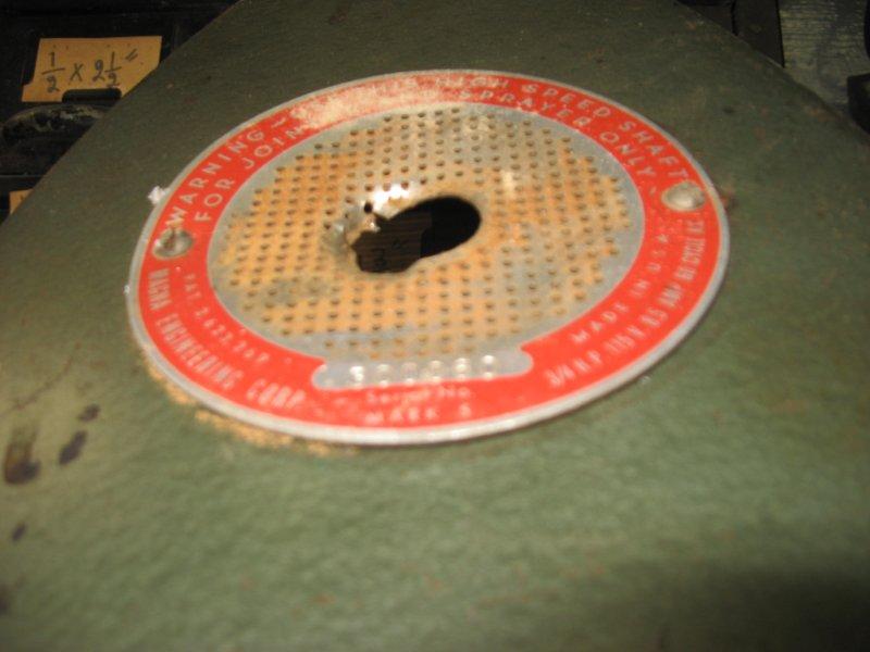

I just brought a new to me Greenie home. Bought it from the wife of the original owner. In the paperwork is this letter. It appears, from the letter, that this was one of the first 1 1/8 hp motors. Cool. I am going through the rest of the paper work and will scan and post.

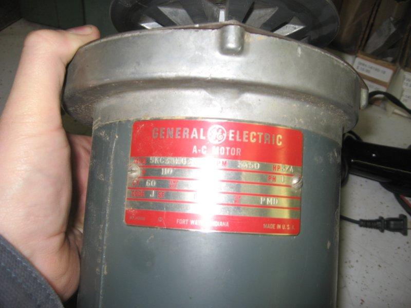

I find that very interesting! That is the first I was aware that any greenies had other than a 3/4 hp motor. Are you sure that is what the 'more powerful' meant? What is the sn of your greenie?timdgarry wrote:[ATTACH]15950[/ATTACH]
Goldies were made with a 3/4 hp motor up until the early sixties.

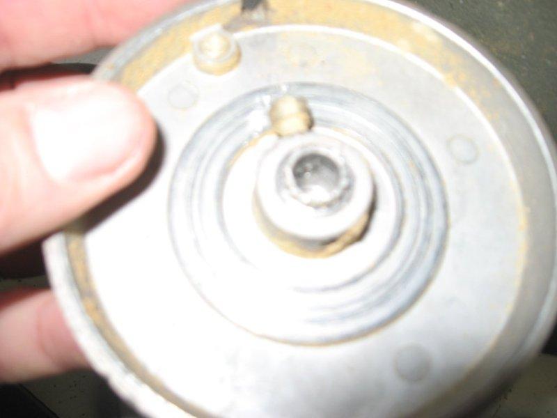

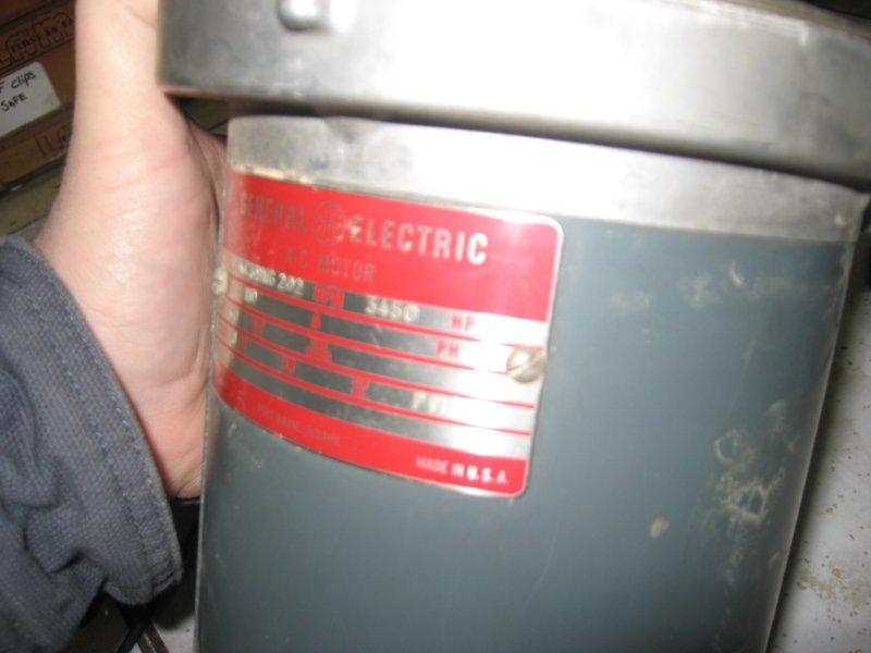

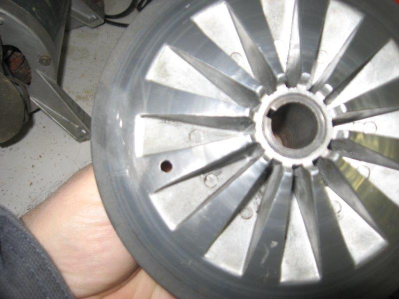

Well JPG40504, you called it! I took the motor pan and belt guard off and took the motor out. As you can see in the picture, it is a took the motor out as you can see in the picture it is a General Electric 3/4 HP motor. The Control Sheave and the Idler Sheave were screwed together, because the teeth were GONE on the speed control knob. Here are some pictures.
- 300060 Motor GE 3_4 HP 2.jpg (44.13 KiB) Viewed 1988 times
- 300060 control sheave.jpg (53.93 KiB) Viewed 1986 times
- 300060 Motor GE 3_4 HP 1.jpg (52.99 KiB) Viewed 1985 times
- 300060 speed control.jpg (36.42 KiB) Viewed 1983 times
- 300060 idler shaft vent and SN.jpg (50.85 KiB) Viewed 1978 times

I recommend getting the crank rebuilt. Those teeth do not control the speed, they merely cause the outer indicator ring to move. Watch for it on e-bay. He replaces the stripped cast aluminum gear teeth with a steel pinion gear.
Curious why the sheaves were screwed together. What else is funky with the speed control???
The bearing with the wire loop is missing off of the idler shaft, that would make it run at one speed or not at all with the sheaves being able to move at will. The sheaves being screwed together, made it run at a fast speed all the time. Do you have a link for the guy who rebuilds them?
