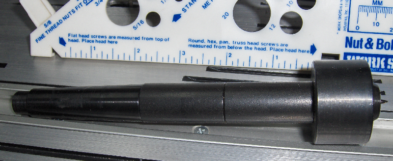

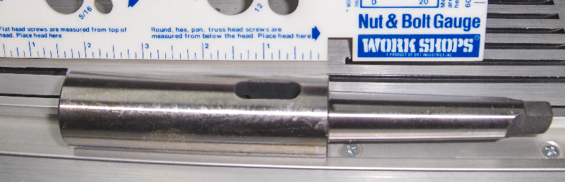

None, the trick is to extend the reach of the live center on the tail-stock.dusty wrote:Hey, Paul - give me a little help here. Which other threads tell how to extend the reach of the quill?
The ball bearing on the Shopsmith live center unscrews and Shopsmith sells a a steel rod threaded on one end to fit the bearing and a hole on the other to reattach the back half. You can use up to two of these and each one extends the center about 1.5 inches. One of these comes with the Lathe Duplicator.
The other option is a #2 or #2 Morse Taper extender, pictures of both are below.

Thanks Paul. You could do more to help me with this problem than this response - unless you wanted to send me an extender.
I think I have learned something in this post that I didn't expect. Is the tapered end of the live center an axample of a morse taper?
Thanks guys. Every day I learn something.
