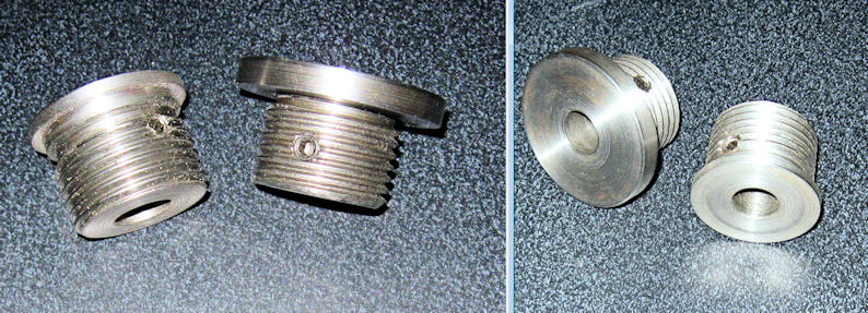

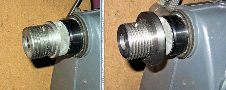

I had collected a lot of chucks and face plates over the years that screw onto the 1 1/2"x8 tpi spindle of my Southbend metal lathe and thought it might be handy to be able to use some of them on the Shopsmith, so I made these adapters:

The diameter is large enough to allow the 5/8" SS spindle to be inside the threaded portion of the adapter, making for less overhang! The thread is quite big and it took me quite a while to make these, so if Penn State came out with them for $15 to $20 like their others, I would consider them a bargain.

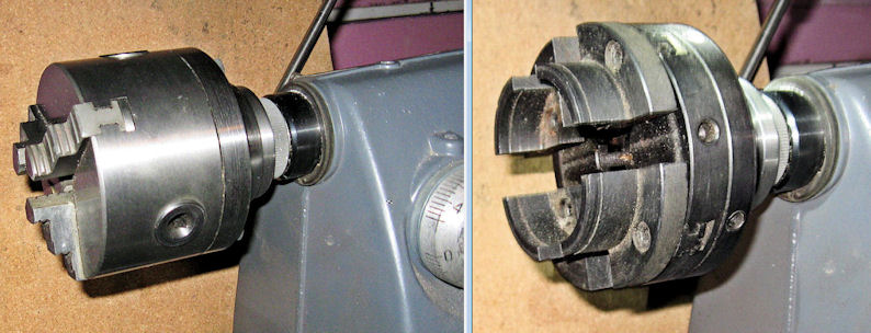

The scroll chucks for metal or wood fit well:

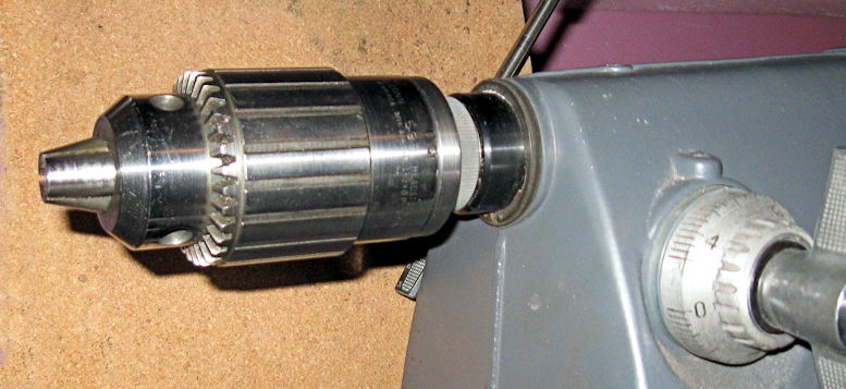

This big Jacobs chuck will take up to a 3/4" bit shaft but fits with some runout::( : It might have fit better if I had a horizontal register flat like the lathe does, instead of the vertical ring pressed on the adapter back end, but the ring was easier and necessary anyway.

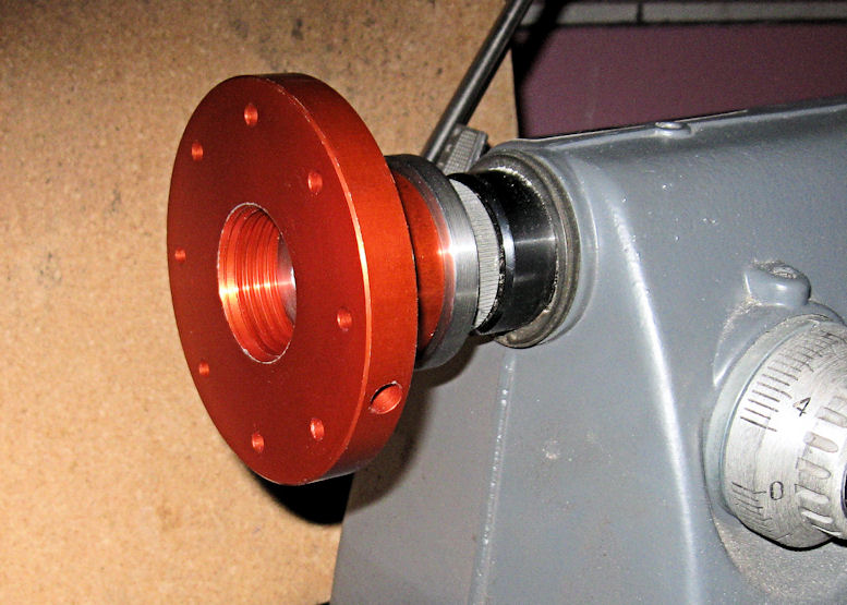

Here is another type of face plate:
[ATTACH]16179[/ATTACH]
[ATTACH]16178[/ATTACH]

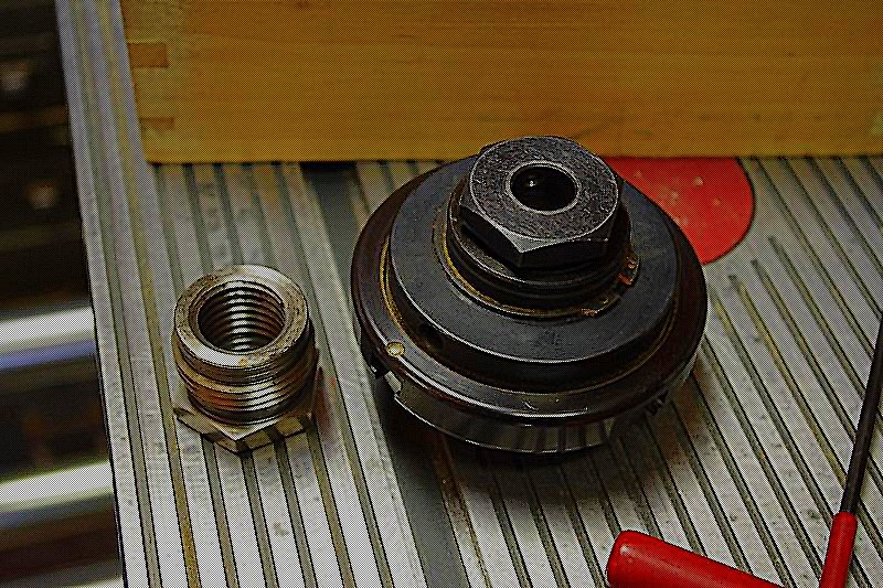

Those Nova chucks are of a universal type in that the female threads on them are 1 1/2" x 8 TPI, so it will mount directly on a lathe with a spindle of that size. To mount the Nova chuck on lathes with different sized spindles you need the appropriate adapter/insert. The Shopsmith adapter/insert (Type F) has a male threat of 1 1/2" x 8 TPI to fit into the female thread on the chuck and a 5/8" smooth bore to fit the Shopsmith spindle. The "D" insert/adapter has the same 1 1/2" x 8 TPI male threads and 1" x 8 TPI female threads to fit many of the popular lathe models.
Here's a photo of my Nova chuck with the Shopsmith "F" adapter/insert mounted in the chuck, with the 1" x 8 TPI "D" adapter/insert beside it.

pennview, thanks for the photos. If I had known about their 1 1/2x8 adapter, I could have saved myself some work, though it was fun making them. I am going to order one from woodcraft though; theirs may fit that big Jacobs chuck better.
