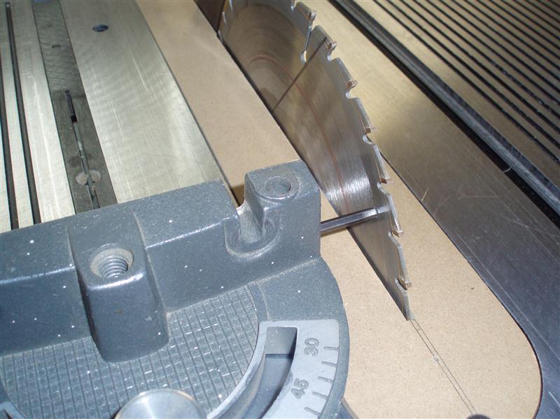

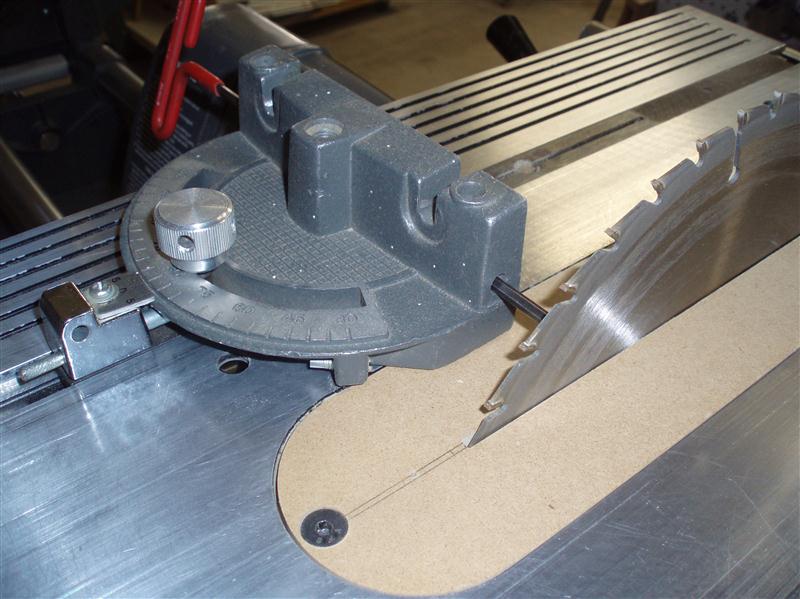

I am not sure that I know what a "wonky" saw blade is but I am going to pretend that I do and suggest a way to verify whether or not yours is wonky.
With the power off and the power plug removed from the wall outlet:
Mount a miter gauge and install an allen wrench as shown in either of the two attached photos. The allen wrench should just barely touch the saw blade.
Manually rotate the blade and watch (listen to) the blade as it turns. If the blade is wonky - you should see proof of that by doing this.
The same test can be done by laying a ruler or small stick, pencil or screw driver on the table top - touching the blade in the same manner.
[ATTACH]16231[/ATTACH]
[ATTACH]16232[/ATTACH]
Repeat the test with the allen wrench close to the arbor (center of the blade). There should be the same relationship there.
All the allen wrench is doing is providing a visual point of reference that will allow you to see what the blade might be doing.
