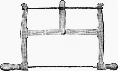

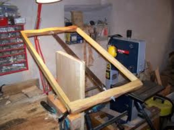

Heck... you don't even have to have a bandsaw.
For the thousand years before the last 150 they used something like this to resaw a wide board into thinner ones. With a good blade (like a section of modern bandsaw blade) it will cut faster than you might think. Commonly called a "frame saw".
[ATTACH]16335[/ATTACH]
Curved cuts were made with one like this "bow saw".
[ATTACH]16336[/ATTACH]
If you use your bandsaw to resaw a wide board be sure to use a tall fence / guide and be sure that it is parallel to the blade.
