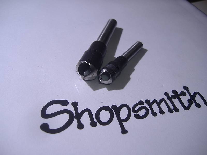

Hi Dusty,
For the hard board I use what is called a shear-cutting countersink and depending on size and feel a speed of slow to D.
This a set of a 3/8" and 1/2" both showing where the chips are ejected and then in the next picture is the cutting face.
[ATTACH]16419[/ATTACH]
[ATTACH]16420[/ATTACH]

reible wrote:Hi Dusty,
I ordered these from Lee Valley just a few minutes ago. The mail man had just delivered an order of stuffed animals to SWMBO. I thought the timing was just right.

I received my order from Lee Valley and these bits do work well but I do not believe they are any better than the others I have used previously. After using a few different bits, I have concluded that most of my problems were "technique" and not hardware related.
If anyone cares, these bits were made in China. I would have looked elsewhere if I had known before I ordered.
