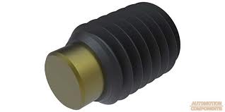

One that I am fond of is a brass tipped set screw. Generally non marking on steel and reasonably self locking. I'm out right now but need to pick up some more. IIRC my Ace Hardware carries them but not very cheaply. Still it is cheaper than a drive to Indy. Then again there are an awfully lot of places to eat in Indy.
[ATTACH]16456[/ATTACH]
- temp brass tipped ser screw.jpeg (3.91 KiB) Viewed 87143 times
Where do you use these? Maybe what I should ask is "Do you chose to use these in lieu of specified tips"?robinson46176 wrote:One that I am fond of is a brass tipped set screw. Generally non marking on steel and reasonably self locking. I'm out right now but need to pick up some more. IIRC my Ace Hardware carries them but not very cheaply. Still it is cheaper than a drive to Indy. Then again there are an awfully lot of places to eat in Indy. ]16456[/ATTACH]
