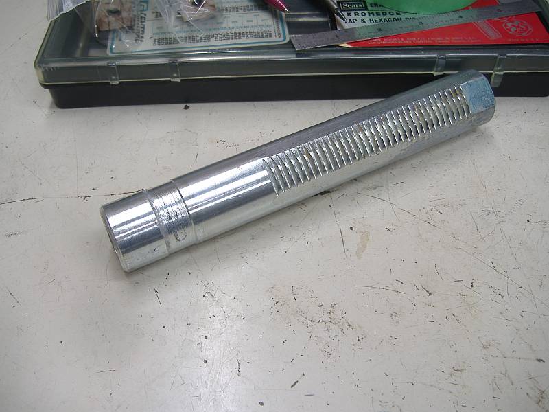

[ATTACH]16604[/ATTACH]
I'm working on yet another project and was hoping to find an easy solution to using a pair of these rack legs from the lathe tool rest to support a table sort of like the lathe duplicator has.
I could use wood but I was hoping for a more metal like solution if I could find one. Givens are it needs to be low profile, should work with both the 500 and 520 carriage spacing.
My first though was angle AL and then drill to use a muffler like clamp, that lost out when I priced the thicker material that I would need... so yes it has to be low cost.
Anyone?

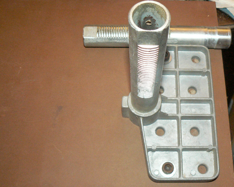

Lathe Dup table brackets and posts
The posts are the same as earlier M5 etc.(513904), that has been replaced with 514416 in later versions.
The bracket is 514697, but is not a current part #.
[ATTACH]16662[/ATTACH]
The outer holes provide the spacing for the smaller carrier post spacing. The brackets are identical. A single set screw secures the posts into the bracket.
