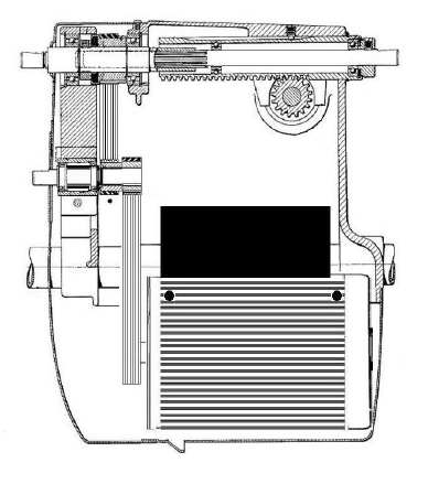

Where can it be? I would think the quill. Nothing else is changed as a result of the quill being extended.
With the quill extended and the PowerPro turned on, does holding the quill or putting lateral pressure on the quill change anything?
What if you take the quill out completely?

Mill marks on the splined shaft that rubs on the nylon coupler and possibly a bent shaft that makes that more apparent.
Like I said - guess. ;)
Or the gear teeth on the bottom of the quill body, but shaft not rotating should not affect that.
Oblong hole is likely a bad bearing. Is one perhaps 'missing'?

The failure of the quill to retract suggests to me that the set screw that rides in the quill (half-dog IIRC) is over-tightened and is causing binding on the quill. That set screw is hidden under a putty/lead plug on top of casing).
If the 'old' quill operates correctly in the 'new' headstock, I would suggest(to SSCS) that you return the quill for 'examination by them.
IIRC you already tried the old quill in the new headstock.
Question is, is the new quill feed stuff relevant/culpable?
Have we not already eliminated the half dog set screw?
If not, a definite candidate. I thought the quill had been already removed etc.. However rpms would not change vibration with that.
It has to be something sensitive to rotation.
