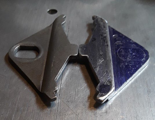

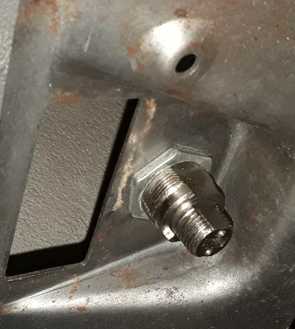

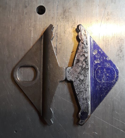

The parts that attach to the lock that provide interlocking of the switch between fwd and rev.

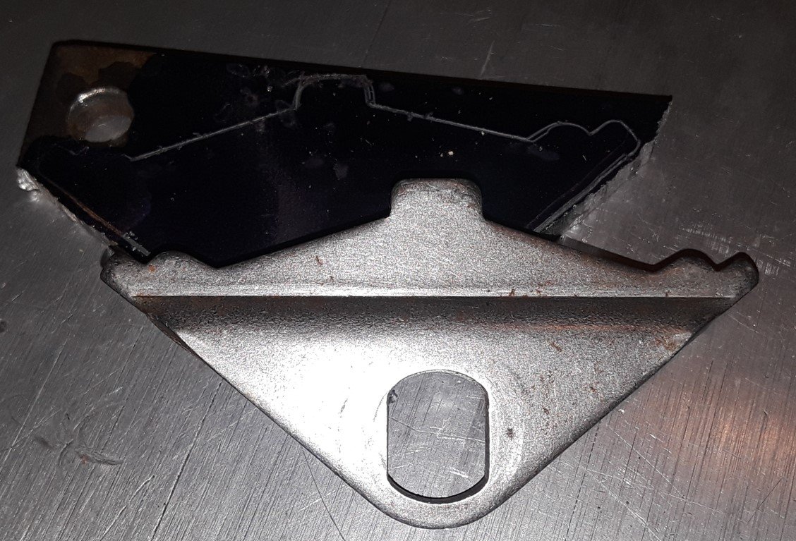

Well no, he doesn’t have that part but I’m 80% there so will keep looking. Worse case I’ll try and make one. This has proved to be a much more difficult adventure than I anticipated but I’m retired so I have time to look around. Thanks

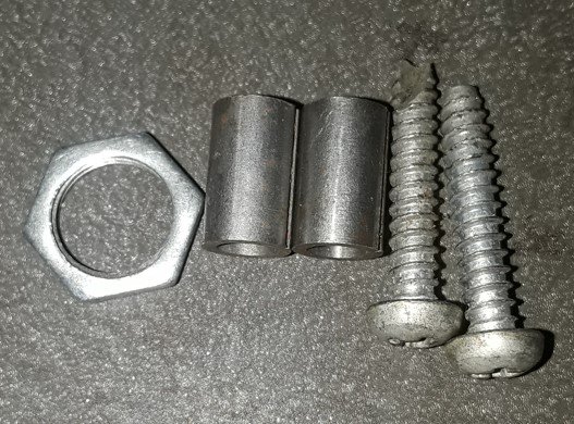

Mike, I think I got you covered for this part. It will be very difficult to fabricate if you don't already have one to use as a template. I imagine finding one sold separately is nearly impossible? It also has a 3/16" (overall) offset bent into the plate that I can't bend, but I should be able to machine the offset. I'm going to give it shot. You're going to need the parts in the bottom two pictures, 2- thin nuts (one for the lock bezel, one to attach the interlock plate), the spacers, and the screws. I can provide dimensions when needed.
80% done means we need some progress pics. 😉
