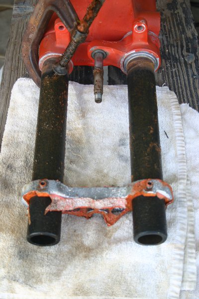

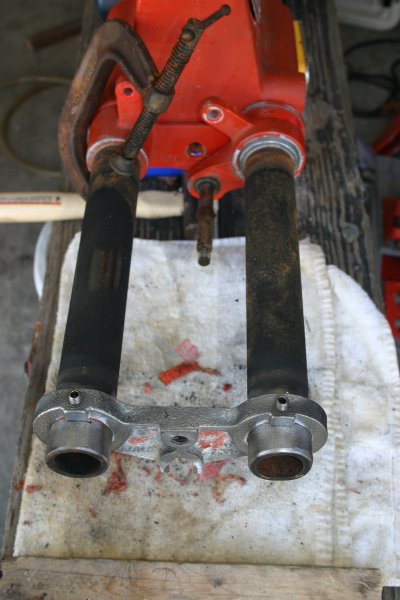

The electrolysis process ran overnight cleaning the rust off the tie bar end of the way tubes. As you recall, I could only submerge the tubes up to the aluminum speed changer since aluminum cannot safely go into the solution. I checked after 15 hrs and the tubes were free of rust.
The shot on the left is what they looked like immediately after taking them out. Notice that the electrolysis also works great as a paint remover!! The tubes are still covered with black oxide residue that brushes off real easy. On the right, I cleaned the tubes but only up to the tie bar with a brass wire wheel mounted on a drill. I was then able to tap the tie bar with a hammer and wooden block alternating side to side to remove it. It came off pretty easy.

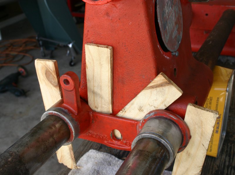

So, I cleaned the way tubes all the way up to the speed changer. I was curious to see if it would budge since the tubes were now rust free all the way up to it. If I could move it, I figured I could get it off without the "Kroil". I set up a bunch of wooden wedges between the headstock and the speed changer and started gently tapping them with a hammer.

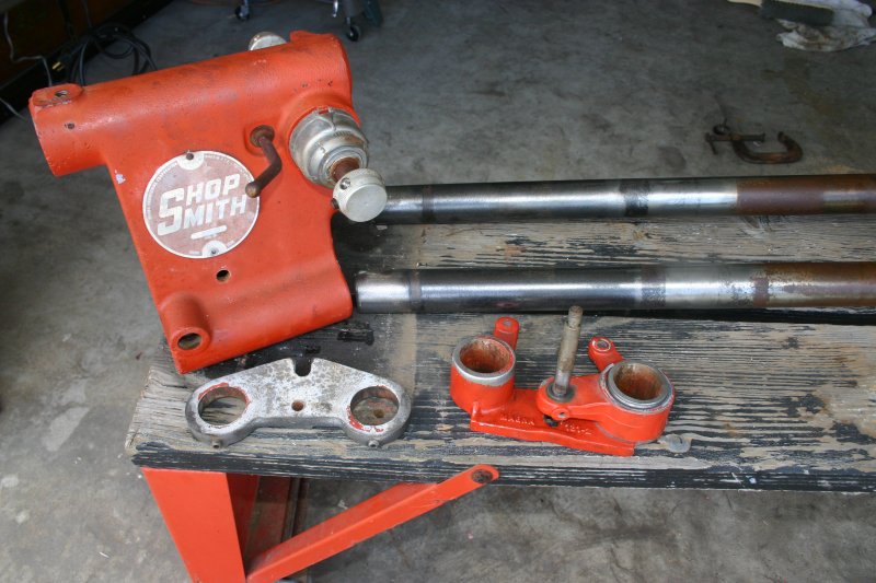

As I tapped, I noticed the gap opening up. What I thought was the speed changer moving actually turned out to be the headstock. Even though I hadn't removed the rust from the tubes on the other side of the headstock, it was actually moving in that direction. As it moved, the tubes under it (on the speed changer side) were rust free. Makes sense since the headstock was protecting the tubes from the weather. I then started pounding the headstock only with a 2x4 and mallet. Got it to move about 6" pretty quickly. That gave me room to be able to tap the speed changer down near the way tube with a 2x4 and mallet in the opposite direction toward the section of the way tubes that went through the electrolysis. It wouldn't budge however. Remembering what farmer had said previously about tapping it in the opposite direction, I tried that, tapping it toward the headstock. IT STARTED TO MOVE!!! The more it moved, the easier it got since it was moving onto the clean tubes that were protected under by the headstock. Underneath the speed changer was nasty thick white corrosion. Eventually, the speed changer was completely onto the clean section of tube and was moving by hand. That gave me a chance to clean the white corrosion off the tubes and try sliding the speed changer back were it came from. It slide right over the spot where it was previously frozen. SUCCESS!! I was able to get the speed change off the way tubes!!! Since I felt lucky, I also tried removing the headstock. Although it didn't move quite as easy, it moved with gentle persuasion with the hammer and 2x4. I got it it off with only a little effort.

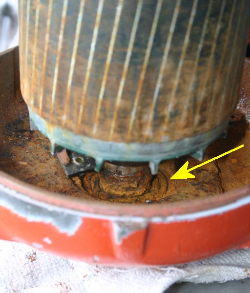

Since I have room in this post for one more photo, thought I'd show you what my rear motor bearing looks like. I think that is DEFINITELY going to take the "Kroil" to dislodge it from the housing!!!
