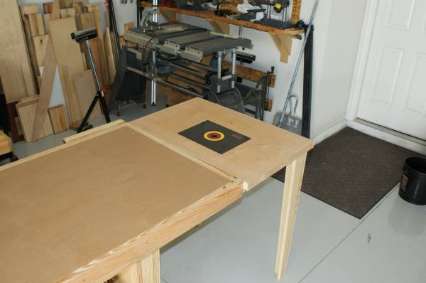

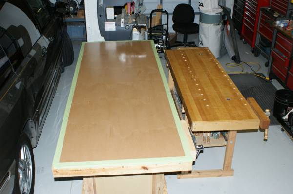

I will try to post a couple of my workbench that is from a set of plans from Woodsmith shop TV show. This thing really weighs a ton and has twice the surface of the old Sjobergs workbench. The top of the bench is 4 layers of MDF and the base is dimensional southern yellow pine lumber which I had on hand. The bench is about 8' from end to end and I have since added a router table to one end which extends the table to just under 10'
The top is as dead flat as I could make it. A 4' level does not rock from end to end when put on the top so it makes for a nice assembly table for long projects.
[ATTACH]14875[/ATTACH]
[ATTACH]14876[/ATTACH]
I added two quick adjusting woodworkers vices thatI got from Harbor Freight for half the price of new ones from Woodcraft or Rocklers. It aint fancy but it serves my purposes.
