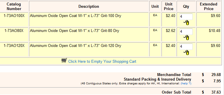

I found this company that supplies various size belts at a good price:
http://customsandingbelts.com/abrasive.asp
[ATTACH]15624[/ATTACH]
Jim
510 upgraded to 520, bandsaw, Homecraft jointer, universal lathe rest, Craftsman tablesaw w/Delta fence, standalone belt/disc sander, power miter saw, a bunch of smaller stuff
Question remains: How well will they work on a shopsmith band saw with a canted and non-crowned wheels.

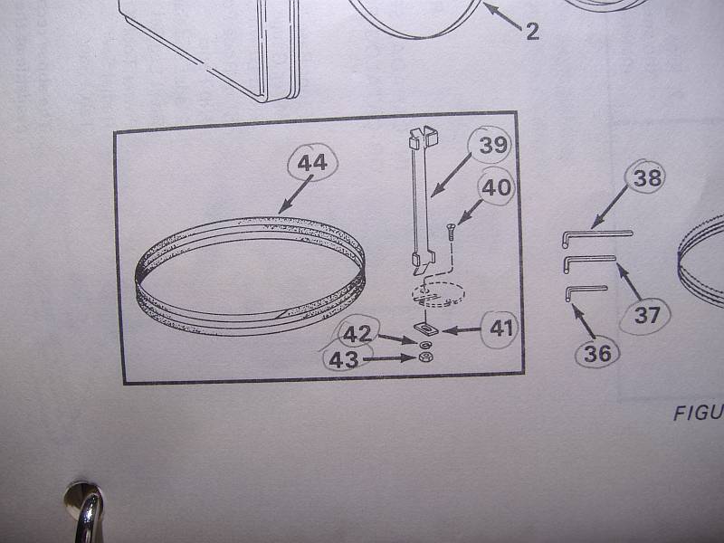

Thanks for the custom belt link. This might be better to do on a regular band saw. Do they have crowned wheels? At least with a long belt it would last longer but if you tore it you would have just wasted a long belt.
Seems you would need a back plate (platen) or the paper would just push away from the wood. There would be 6" of free space for the paper to flex.:eek:
This is what the parts look like diagram wise for my sanding attachment.
[ATTACH]15638[/ATTACH]
Pretty simple now that I look at it again. It uses a 1/2" wide belt only.
