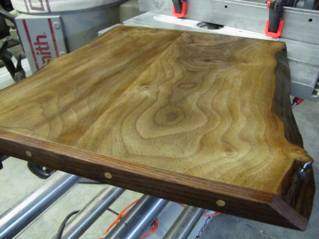

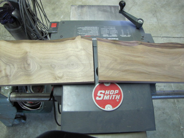

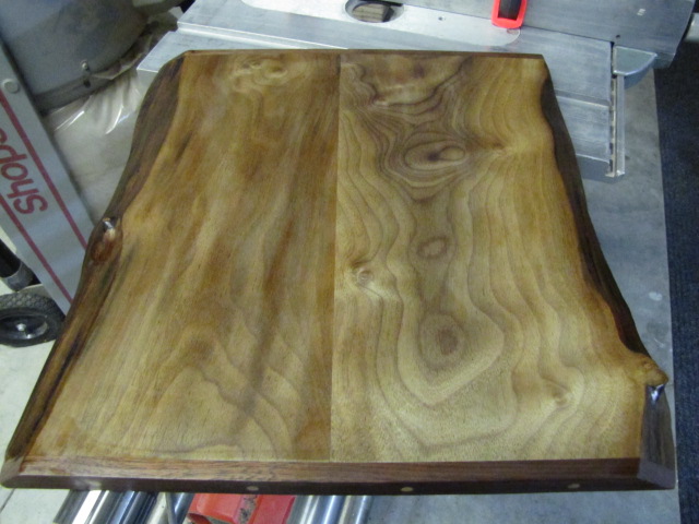

My oldest daughter wanted a cutting board, but something a little different with a natural look.

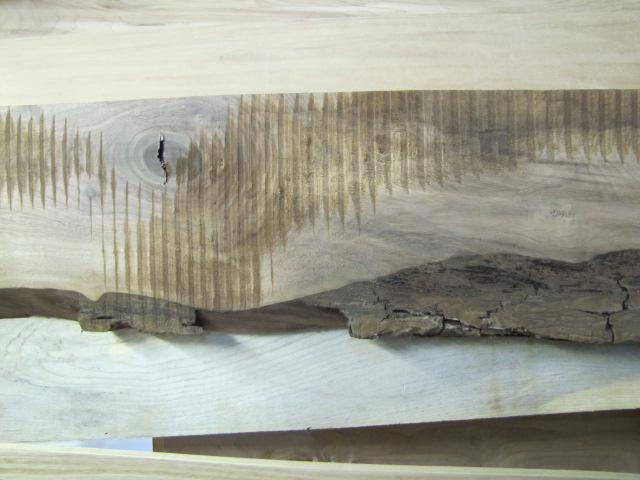

I found this piece of walnut at the local wood supplier. It was awesome to use the planer really for the first time-with newly sharpened knives :) . The horizontal bore I thought would be very precise and simple, but I did notice that the pressure put on the board, and where, will make a difference as well as a little table slop on the 54 greenie.
[ATTACH]16211[/ATTACH]
[ATTACH]16212[/ATTACH]
[ATTACH]16213[/ATTACH]
[ATTACH]16214[/ATTACH]

Nice!!!!!!!!!! What did you use to treat the wood with? Also, do you thing red cedar would hold up for a cutting board?
mrhart
Posts: 938
Location: Meridian Idaho
Post by mrhart »
jc24fan wrote:Nice!!!!!!!!!! What did you use to treat the wood with? Also, do you thing red cedar would hold up for a cutting board?
I just used an oil finish from Lowes, can't recall the brand as I'm not at home. It was for salad bowls ect on the label. A local spoon maker just uses mineral oil from wall greens. I looked on the label I have but it was too vauge to tell if thats all it was.
I am fairly new to woodworking, but from what I understand cedar would be too soft. Hardwoods are what I was told.

jc24fan wrote: Also, do you thing red cedar would hold up for a cutting board?
It's to soft to use for that application.

I don't think I would ever have thought about a natural edge cutting board. That is so cool. I can see that, especially with bookmatched grain. Very unique and very simple, two things I really like in any project.
It looks very nice, and you did an excellent job, but did you accommodate expansion across the ends?
mrhart
Posts: 938
Post by mrhart »
No sir I guess I did not. I glued and doweled between the slabs and the ends.
I have a cutting board that was made for my wife 16 years ago that has warped or cupped up on the ends. I had seen a table being built on the woodwrights shop, and putting the end pieces on the table with dowels or pins would prevent that. I didn't think about expansion at the ends.
I need to make another one...suggestions please.
