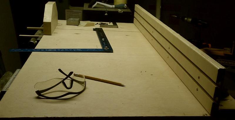

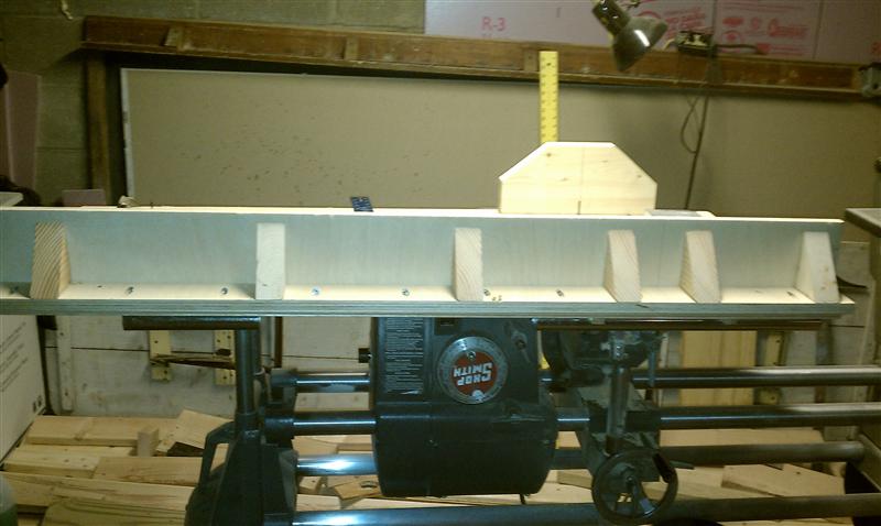

I decided to make a sled and here are the pics in order of assembly
[ATTACH]16383[/ATTACH]
[ATTACH]16384[/ATTACH]
[ATTACH]16385[/ATTACH]
I put T-slots in the fence for stop blocks.
[ATTACH]16386[/ATTACH]

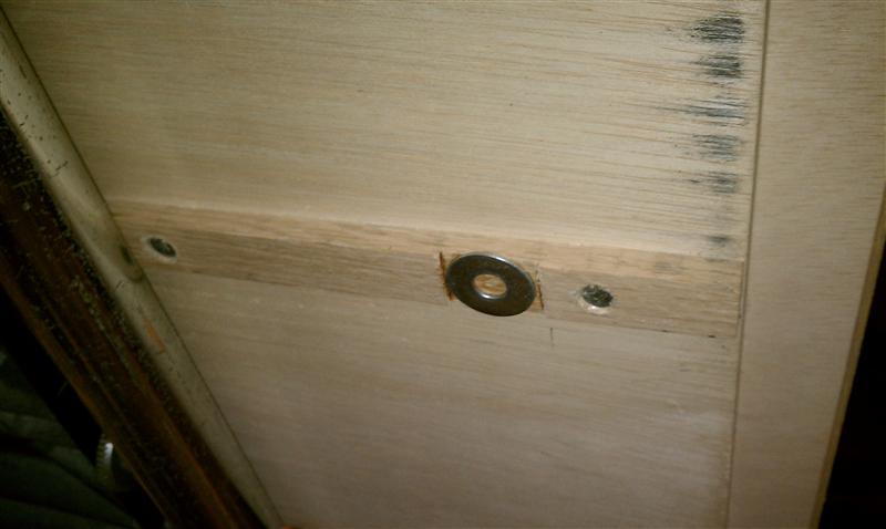

I superglued washers to the bottom of the runners so
the sled wouldnt come out of the miter slots

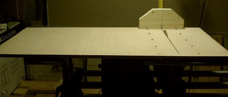

[ATTACH]16388[/ATTACH]
Now thats one big Crosscut sled

Looks good. If you have not had a cross cut sled, you will soon wonder how you ever managed without one. For anything more than a few inches wide, a sled is a great tool.
How wide of a board can you cut? I thought mine was huge but I do have occasions when it is not big enough.
THOMRIDER
Posts: 117
Joined: Sun Nov 22, 2009 5:30 pm
Location: Northern Kentucky
Post by THOMRIDER »
It will cut 18 inches wide
the sled and fence are 4ft. long
SHOPSMITH 510, SHOPSMITH BANDSAW, AND MANY MANY MANY OTHER POWERTOOLS
algale
Posts: 4841
Post by algale »
THOMRIDER wrote:It will cut 18 inches wide
I think anything over 3 feet long qualifies as a cross cut toboggan. :D
My new crosscut sled
My sled is 36" wide and 22" deep. The width is adequate. If I need support way out there I move the headstock left and use an extension table.
I have some difficulty with wide items. The blade is sometimes too close to the fence on the sled (can't pull the sled far enough without loosing lateral stability).
