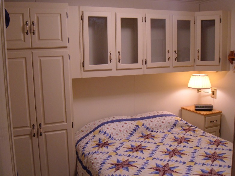

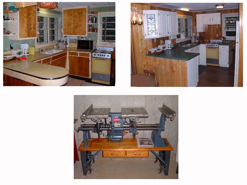

As a kid, I grew up with the old (then not so old) 10er, so I learned woodworking skills on it. After I moved into my place & my dad still had the Smith, I decided to build my shop around separate tools & began to accumulate them. When my dad got too old to use the 10er, I received it from him and, since I had a shop full of separate tools, I relegated it to our summer lake place in case I needed to do stuff there.
Then came:
[ATTACH]16442[/ATTACH]
and
[ATTACH]16443[/ATTACH]
I replaced the old 1950's kitchen cabinets & added storage in the tiny bedroom with stuff from a home that was demo'ed for a mini mall.
All the cabinets had to be cut, re-sized, and reconfigured to fit my space & ideas. All the paneling was recut from a previous (Shopsmith) paneling project. In the end, nothing was wasted & the 10er was up to the task.
As a result of this interior remodel project, I fell in love with the Shopsmith all over again. I gave my son my table saw & drill press, and sold off the other separate tools I had, brought my 10er home, and found another to replace it at the cottage. In my search, I found a Greenie MK5 & got hooked on it as well. After that, I got a little nuts & ended up with the cottage 10er, a shortened 510, a Goldie, my dad's 10er & another 10er.
So, I guess I have room for separate tools but have chosen the Shopsmiths. About the only possible weakness might be the table saw, although I'm tall & like the height. The tilting table isn't my favorite thing, but truthfully, I can't even remember the last time I made a non-right angle cut...and I'll bet that's true for lots of users, too.
