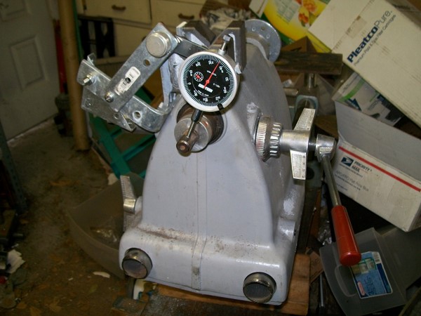

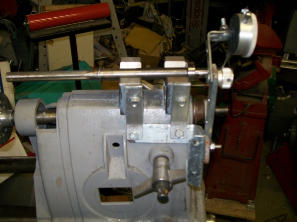

I am finding about 20% of the quill shafts I test have greater than .002" runout. I discarded 7 more quill shafts this week due to excessive runout or the shaft beening bent. I have a modified headstock just for testing the quill shafts and the quills with the shaft installed.
[ATTACH]16619[/ATTACH]
[ATTACH]16620[/ATTACH]
- 100_0302.JPG (71.27 KiB) Viewed 2378 times
- 100_0304.JPG (68.68 KiB) Viewed 2380 times
