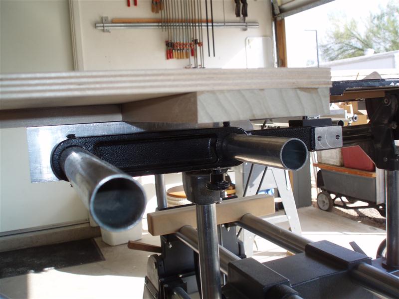

If these are what you are thinking about, I use them frequently. I have also incorporated them into a setup version of my home made outfeed table. They work quite well.
I do try to avoid a lot of weight on the outfeed table when using these. You can cantilever just so much and then something must give. If I suspect too much weight, I simply install the support leg. Either way the table adjusts up and down and can be tilted.
My cantilevered outfeed table.
[ATTACH]16531[/ATTACH]

I like them quite well and have even thought about getting a second set. Of course for me that is a lot of money but for the general population I think the cost is easily off set by the added functions.
Take a look here to see them used on both the front and the rear of the main table. A few other setups shown as well.
https://forum.shopsmith.com/viewtopic.php?t=2757
