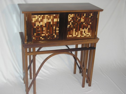

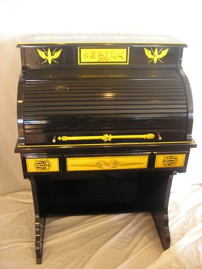

My pride will say that these 2 can only be done by hand. But, in truth a cnc could cut much of the hall cabinet but the doors, well, that was all hand cut and arranged. Who knows but there was plenty of "good enough" in the arrangement of the trestle legs. They were each hand cut into strips, boiled in a large bag, bent around a form and poly glued.
[ATTACH]16635[/ATTACH]
[ATTACH]16636[/ATTACH]

final 1.JPG (43.79 KiB) Viewed 1634 times
hall table.JPG (44.21 KiB) Viewed 1633 times

Really nice work. Is that marquetry on the roll top?

No, it's not marquetry. All hand painted. Had a thread on here about how it was done. General woodworking section a couple pages in.
