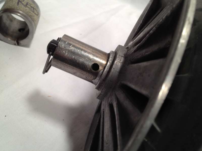

In my post I said my 500 was of a mixed heritage. I have an A casting. My 3/4 hp Franklin Electric motor's shaft does not have an oil hole. But my control sheave does have one. JPG said SS had redesigned the idler bearing. So with my mixed heritage, I'm not sure what vintage of bearing I have. Look here.
[ATTACH]16715[/ATTACH]
This is a picture of my control sheave.
[ATTACH]16714[/ATTACH]
So, do I have the original or new idler bearing design?
So, do I have the original or new idler bearing design? Original water pump bearing and eccentric sleeve.
There is an eBayer selling idler and button bearings. Are there any public specs on these two bearings? Are bearings that can be replaced on an existing shaft commercially available? Not for the water pump bearing shaft.
Or must I buy the entire idler bearing, shaft, eccentric, and idler sheave assembly?
To use the newer idler shaft/bearing, a new eccentric is also needed. The control sheave(and all other parts attached to the idler shaft) are compatible with both versions. Only the shaft and bearings are different, but the eccentric needs to match the version used.
