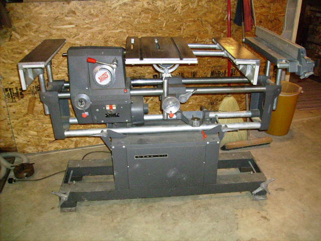

Any other Mark VII owners out there been able to successfully upgrade the casters on these machines? There are a couple of variables that would seem to make this mod tricky. Any advice would be appreciated.
robinson46176
Posts: 4182
Post by robinson46176 »
riddler wrote:Any other Mark VII owners out there been able to successfully upgrade the casters on these machines? There are a couple of variables that would seem to make this mod tricky. Any advice would be appreciated.
I have not given much thought to upgrading either of mine but I agree it could be tricky on the regular set since they sit up inside of the base legs (I guess you would call them "legs").
[ATTACH]16778[/ATTACH]
Mark VII tables 3.JPG (78.38 KiB) Viewed 3886 times
