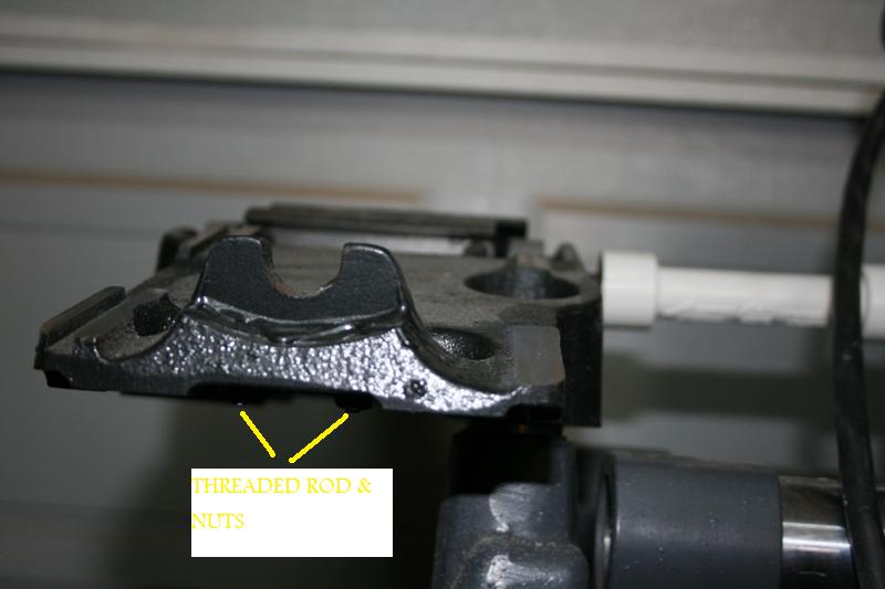

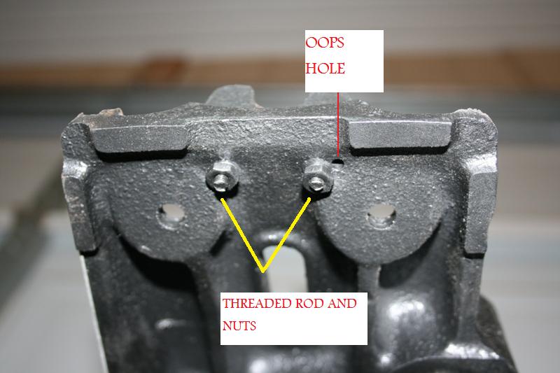

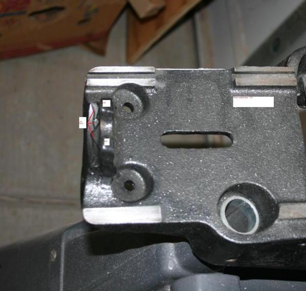

Here are a couple attempts at adding photos I am not use to this version of windows photoshop. I will do gooder next time:D [ATTACH]16948[/ATTACH]
[ATTACH]16949[/ATTACH]
[ATTACH]16950[/ATTACH]
JOINTER 003A.jpg (40.71 KiB) Viewed 1965 times
JOINTER 4A.jpg (57.11 KiB) Viewed 1966 times
jointer 002a.jpg (49.28 KiB) Viewed 1965 times
I think I would start by removing the nut/washers/springs that secure the infeed to the outfeed table. That will allow separating them so as to ascertain why there is no movement and avoid over stressing the adjustment parts.

Thanks for posting those pictures. Figured out my problem. That notch you got going on on your jointer is non existent on mine.
