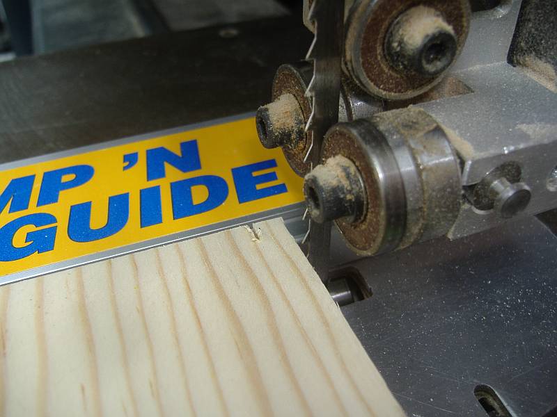

I had to cut some notches today and figured it was time for one of my tips of the day. The notches are so I could use some blind dado cuts and still have the "shelf" full depth.

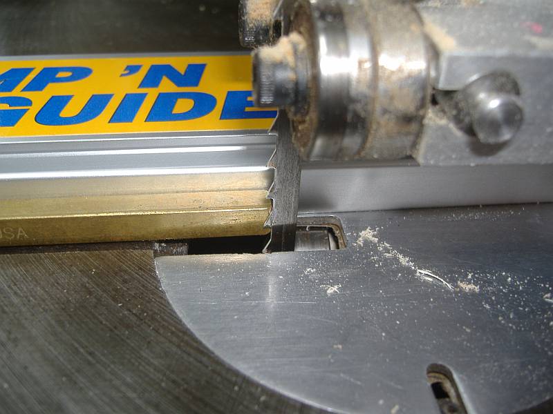

I used a Tru-Grip tool guide as a fence and set the fence to blade dimension to 1/4" using a brass bar and an inside tooth on the blade. In this case I wanted to take a notch out that was 1/4" x 1/4", it could just as easily been 3/8" x 3/8". You can also do rectangular notches also.
[ATTACH]17018[/ATTACH]

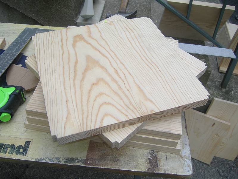

As you can see I just free handed a square to help me remember that the workpiece had to have that operation preformed on it.
[ATTACH]17019[/ATTACH]

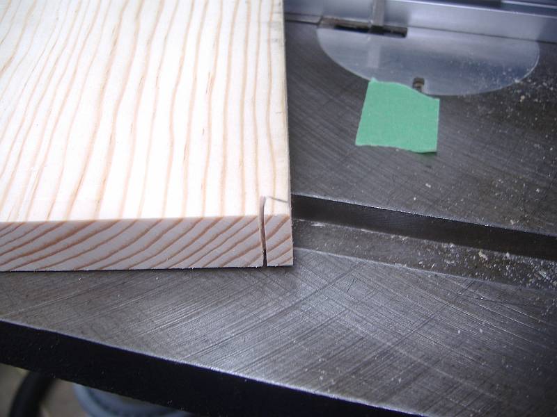

In this case I used some green tape to mark how far to cut.
[ATTACH]17020[/ATTACH]
Not the workpiece is stopped at the leading edge of the cut so the cut is measured from there.

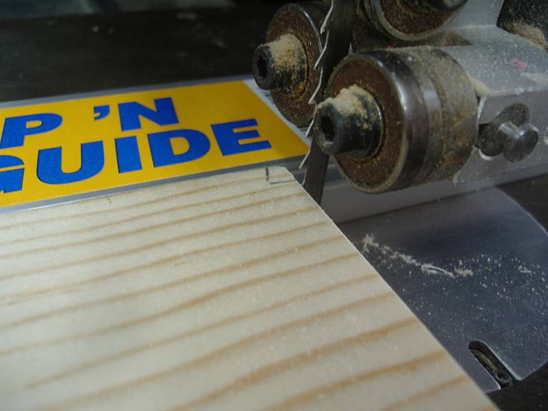

Next I did the first cut.
[ATTACH]17021[/ATTACH]

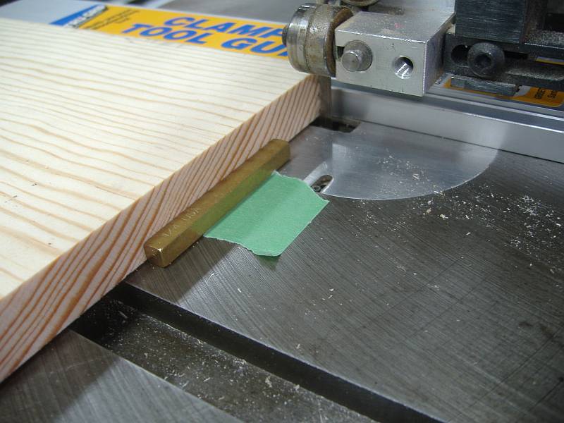

Then flipped the wood to make the second cut. Worked around the workpiece until all the cuts were made.
[ATTACH]17022[/ATTACH]
