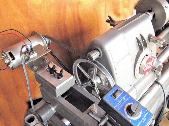

Here is a similar one from frets.com:
[ATTACH]17171[/ATTACH]
Peter

twoblocked, did you see my post that discussed this approach?
https://forum.shopsmith.com/viewtopic.php?t=6453
[ATTACH]17185[/ATTACH]

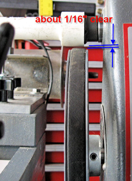

Thanks for the comment holsgo, but I have not done it, ie, used my setup to slow down the band saw, I was only using the lathe mode. I just set it up to check clearances:
My belt/pulley just clears the coupling
[ATTACH]17220[/ATTACH]
[ATTACH]17221[/ATTACH]
But, the coupling is an inch too short if your version has same dimensions as mine:
[ATTACH]17222[/ATTACH]
This could be handled by using something like a 1/2" router bit chuck, a short 5/8" shaft with a 1/2" section, and move the 5/8" drive hub left. OR, mount the motor so the motor support is not between the haedstock and the band saw!:D
My dc motor clears the body of the band saw ok.
BTW, twoblocked, please remind me what the $25 was for.
end on view.jpg (74.53 KiB) Viewed 7146 times
clearance to belt.jpg (67.37 KiB) Viewed 7147 times
extension needed.jpg (53.84 KiB) Viewed 7151 times
Peter

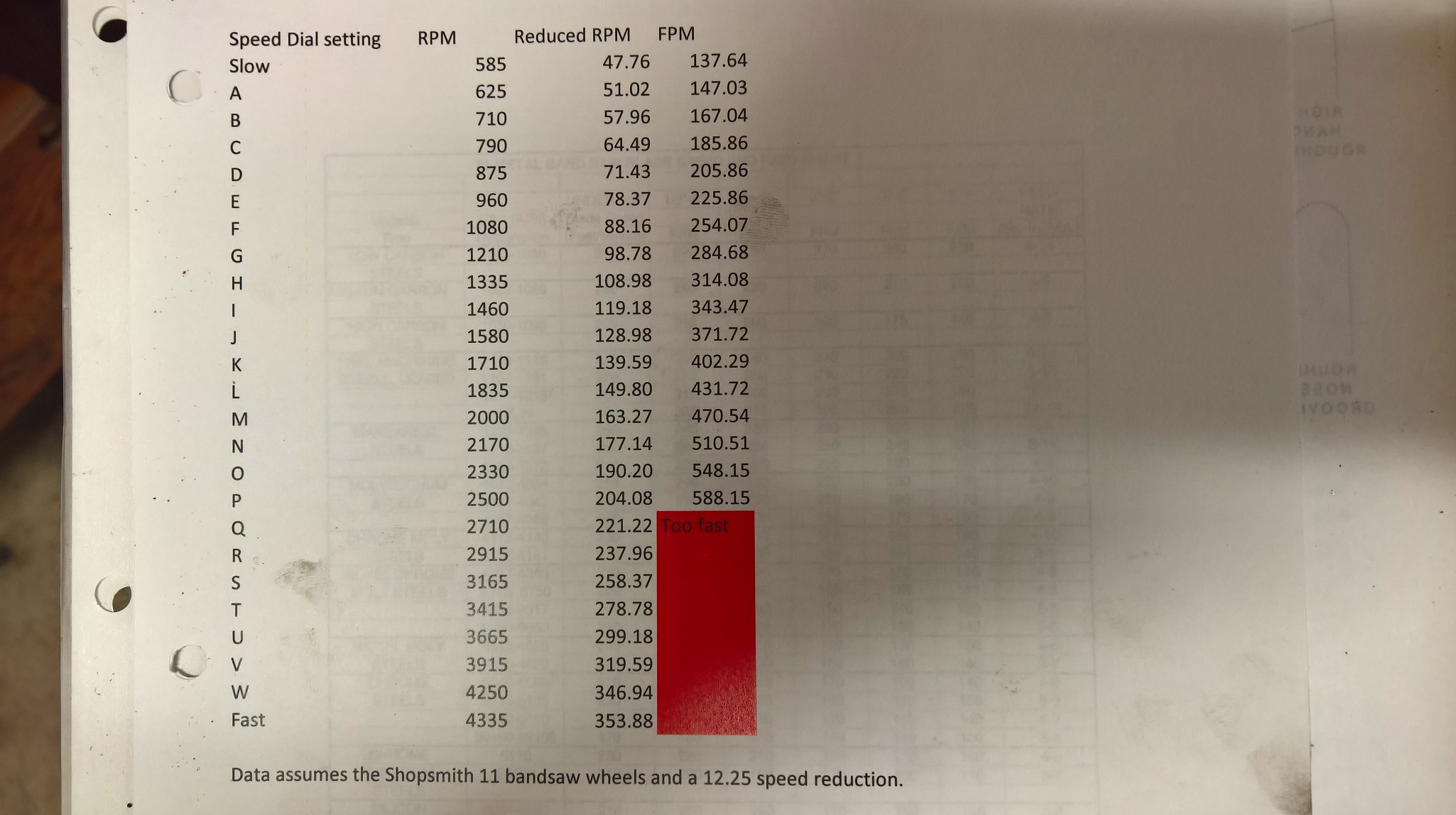

BTW. Making a cross slide for a South Bend milling attachment. Cutting 3/8 and 1/2 carbon steel on the bandsaw. Works fine. Have to have patience as you feed in at a steady rate but the speed is about right. Now, heat is an issue and coolant would be mandatory for much thicker pieces.

Here is an update. Looks like my original file with the FPM data vanished.
Here is a photo of the chart.
