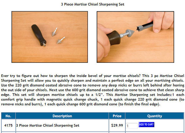

ryanbp01
Posts: 1509
Location: Monroeville, IN
Post by ryanbp01 »
Peachtree Woodworking has a nice mortising chisel sharpening set. Does a pretty good job.
BPR

How about posting a link to it?

peterm
Posts: 576
Post by peterm »
Google is my friend ;) :
http://www.ptreeusa.com/sharpening.htm
Scroll way down to see:
[ATTACH]17304[/ATTACH]
Peter
ryanbp01
Posts: 1509
Post by ryanbp01 »
Peter-
Thanks for doing that. I just like the fact I can sharpen the chisels by hand.
